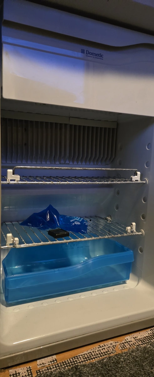

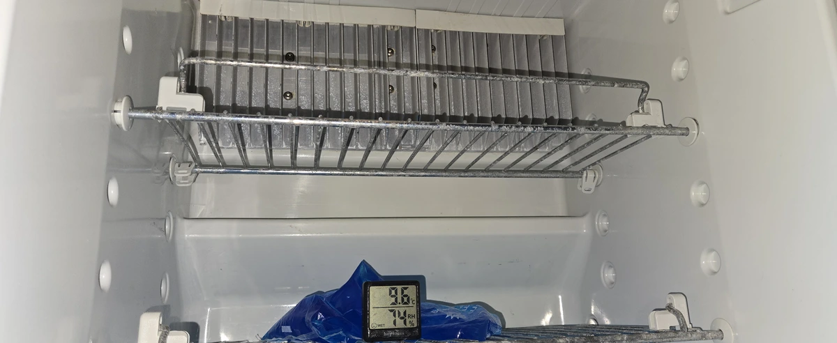

I'm a little bit stumped. It was fine last weekend. Now it's just not very cool. Only about 10c at max chat.... whereas before, around about 3 o'clock position was enough to make the butter so tough I gave up trying to spread it on me toast!
The Freezer is nice and cold, and the vents outside are clear, I can feel the heat from the outside vent also. The seals seem okay. The fins at the back are not obstructed. The only thing in there, is a bottle of water and a thermometer.
It's running on Gas as I had turned it on about 24 hours before setting off.
I know it's a proper oldie, but as the freezer is working. It's not an issue with the cooling parts of it anyway....

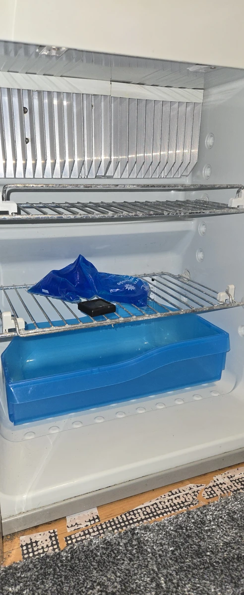

I can see the thermostat, presuming it's the wire above the red line in the picture. That's never been touched from when I bought it. It comes along and down. Sort of tucking between the foils.

Search on here ref " thermal paste".. it's a cheap option to try as it dries out over time, the fact your freezer section is working ok seems to prove the cooling system is working.
I do mine every few years and does seem to help.

I have a thermal gun, which when on the gas, it showed no cooling on the fins in the fridge. Pointing it again at the fins, on EHU, the fins were cooling fine.

It's the same stuff that is used in PC's Instead of bedding the processor in it to disperse heat away, it's used between the aluminium fin plate in your photo and the cooling tubes that run behind to transfer cold into the fridge.
It dries out over time and becomes ineffective, I suspect this is your problem.
If you use the search function on here lots of info will help you, it's an easy job and will make a big difference to the fridge performance
