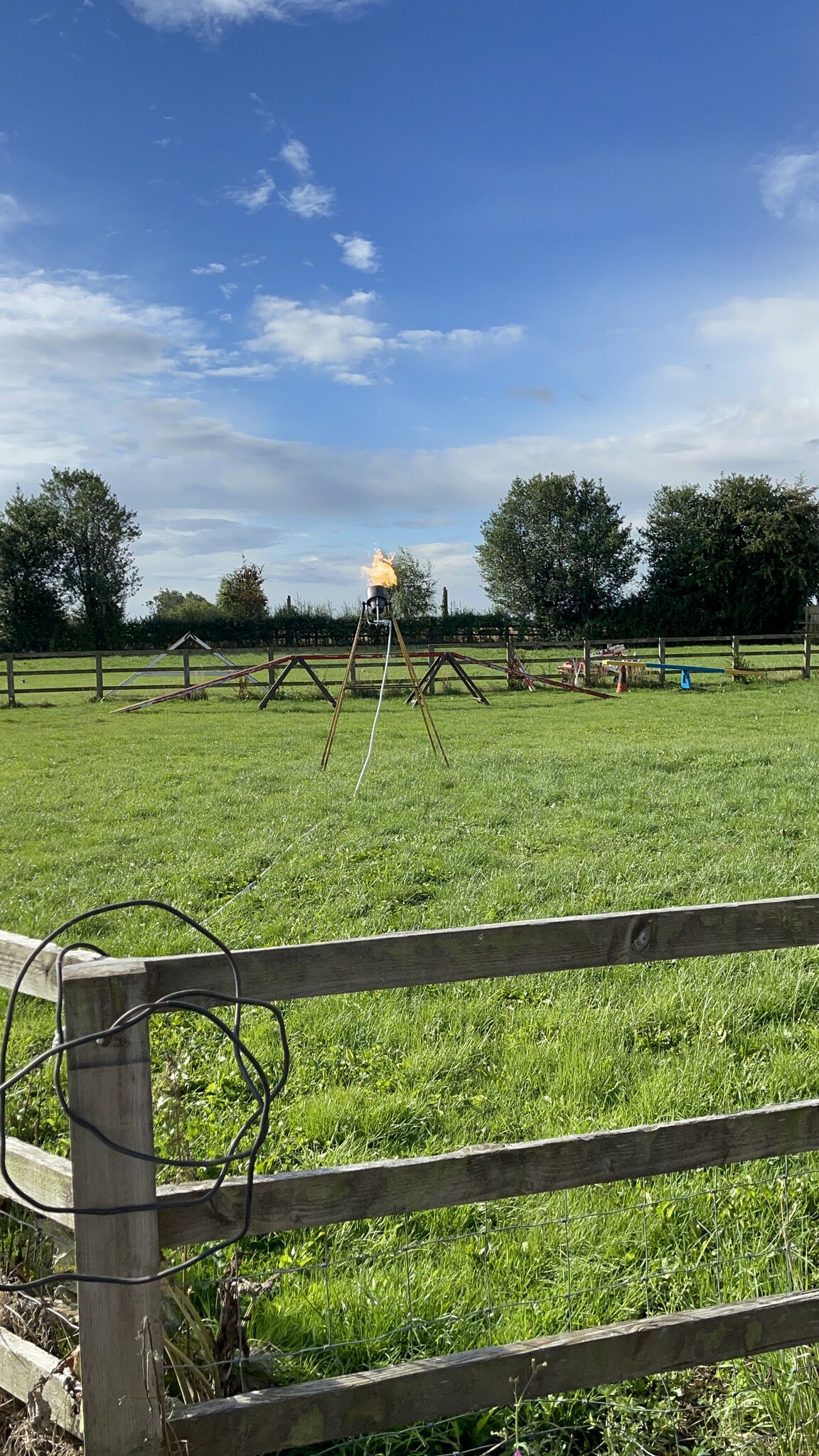

Here’s a liquid burner emptying out a damaged tank.
