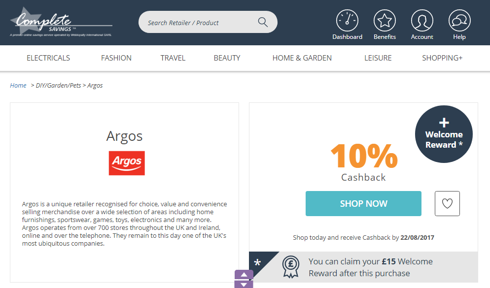

For some unknown reason my laptop refuses to open some links, for example if I go onto the Complete Savings site (cashback site) and click to shop with one of their retailers, eg Argos I just get an error message:

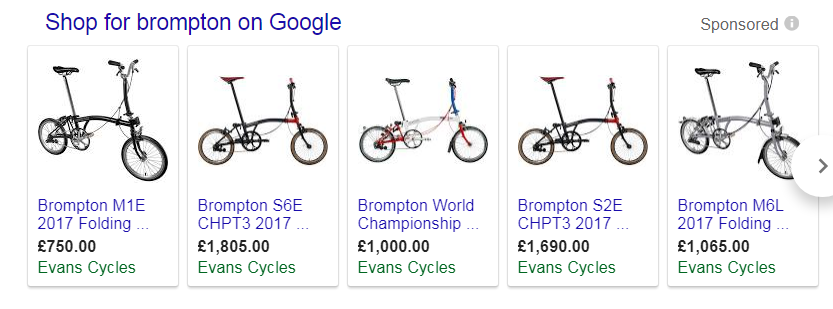

I also can't get through to the advert links which appear on Google, eg:
I've tried all sort so fix it, rolled it back to an earlier date, defrag, cclean, regclean ... bios update, resetting the connections, ip address etc ... all to no avail. I've disabled virus etc protection ... still nothing. You name it and I've probably done it!
My hubby who uses a pc and is hard-linked to the router doesn't have a problem, also my old laptop doesn't have an issue (wifi connection) so its nothing to do with the router/internet.
It is driving me nuts ... I've spend hours on it and still got nowhere .... ARGHHH!!!!

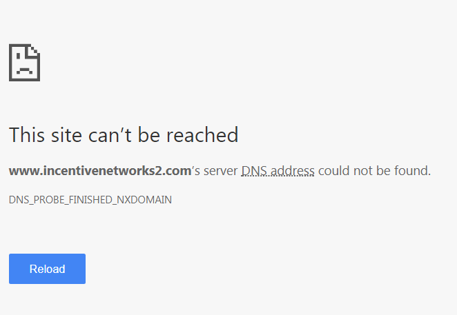

Three possible causes for this. The DNS server you are using has blocked (blackholed) advertisers. You have a custom hosts file which is blocking them, or you have an adblocker installed which is blocking them.
You haven't told us what computer/OS/Tablet/Phone you are using so can't advise further sorry.

Sorry Grom .. just so fed up of it! I'm currently using my old laptop whilst my other one is reconfiguring itself as I've uninstalled some stuff I put on recently (adobe etc) but doubt its anything like that which has caused it but thought it worth yet another try!
I'm on the '3' network and have a HP Probook 455 G2 laptop running Windows 7 Professional (64 bit). I stopped Adblock Pro and uninstalled it to no avail, and am running Adblock having aready stopped it and then started it again as it made no difference; I also tried setting up a new IP address to see if it was a conflict causing a problem but that didn't work either.
I suspect DNS or a host file but don't know how to find out/resolve it. I did lose my finger print scanner but rolling back to a restore point of about 4 days ago fixed it.

ok. For the hosts file. Please bear with me as I haven't touched windows in years so am doing this from memory (don't have windows here).
In accessories look for notepad, right click on it and click run as administrator.
Then open c:\windows\system32\drivers\etc\hosts
Tell me how many lines there are in this file. If it is less than 10 then it is ok.

sounds like a bit of spyware may have got in, download if you can malwarebytes and update (if you can) and run a full scan then reboot.

There are a lot of suggestions online if you Google. One simple one I found was to open up a command prompt and enter "ipconfig /flushdns" without the "" of course. This might work but there are other fixes.

Thanks guys, tried the various web solutions ... loads of them, including flushing the dns, resetting this, that, and the other, ran Malwarebytes etc, even found and checked the host files but nothing nasty in them ... even tried removing the host files completely ... still no joy so hubby has reluctantly agreed to have a play with it for me (he HATES laptops with a vengeance .. give him a normal PC and he's a happy bunny!) and is currently trying to reset it to factory settings and if that doesn't work he'll do a completely new install of Windows ... trying to avoid this as it takes a long time to put all the drivers etc back but I've wasted hours and hours trying to sort it so it's his turn now! :rolleyes:
I'll let you know how it turns out ... good job I haven't sold my old laptop yet otherwise I'd be totally stuffed!!! o_O

Well, the factory reset/restore had done a runner ... gawd knows how/why, so no option but to do a fresh install of Windows 7, once done I had a quick check to see if I could access the ad links etc that I couldn't before and they loaded without a problem so it's working! Yay!!!!!! :dance2:
Still no idea of what the problem was but the fresh install has 'kicked its butt'! :Grin:
Now just the boring and long-winded task of downloading and installing all the drivers and putting all my files etc back on which I'd backed up before the re-install.
