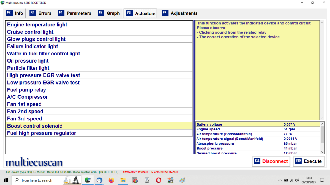

Amazon have them, ours was around £8 then just download an obd app
Simple obd readers may be seen as better than nothing but for a Ducato multiecuscan is the most appropriate piece of software for windows. There is also plenty of experience here and on the fiat forum on how to use it. For example with Tommymac s problem multiecuscan has a test procedure for the turbo solenoid valve
