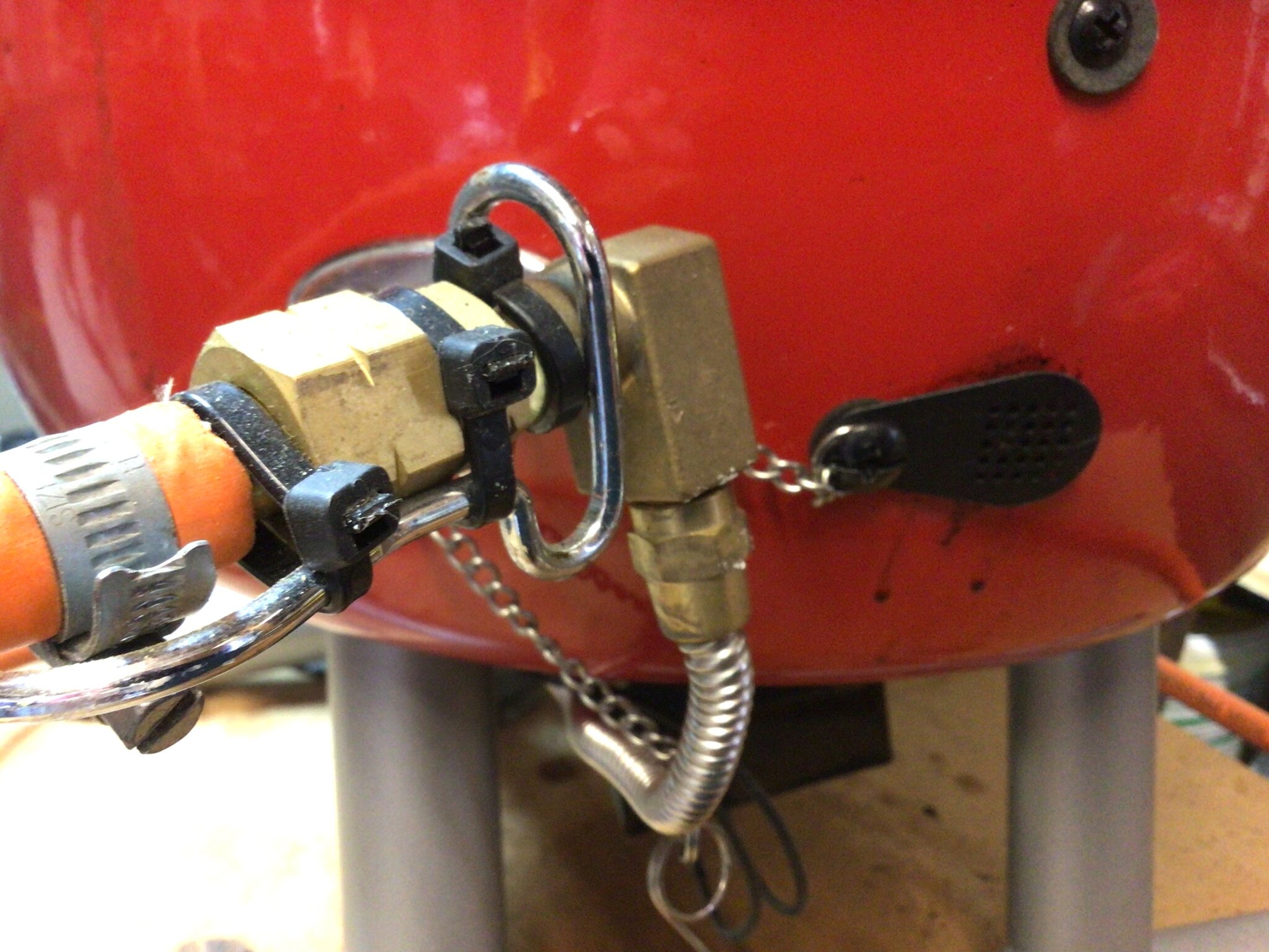

You will need to remove the bbq regulator and fit an adapter between the metal flex hose to the burner and propane hose connector.
also make sure you firmly secure the adapter so the metal felty isn’t kinked or strained. Secured mine to the minin gas cartridge support using cable ties.
remember the threads are all left handed.

Is that on a Charbroil X200?
Looking at the relevant page from the owners manual I linked above, it doesn’t appear to have a flexible hose or compatible L/H thread fitting to connect to. The combined adjustment valve/regulator and it’s connection looks to be specific to their appliance.
