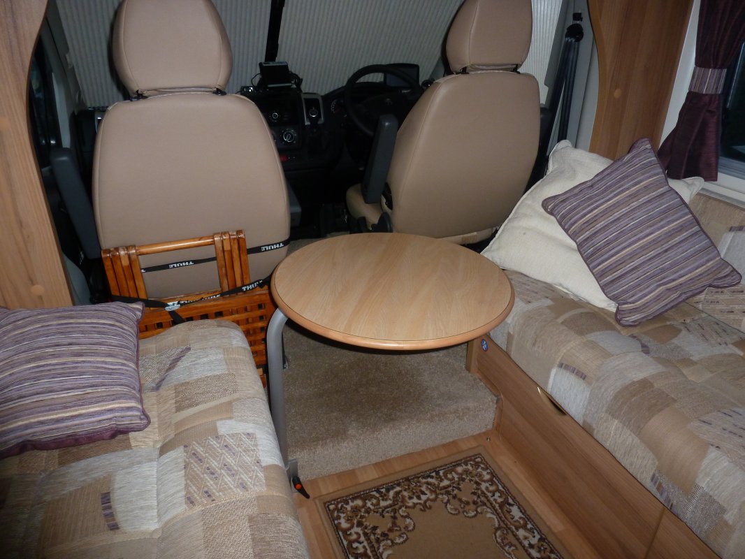

The cranked alu tube sits on a bottom bracket with a plate and a top bracket bolted through the bench side panel.

This is ours that I've added to the Bailey. Mine is only screwed to the step but bolted and reinforced through the end of your base panel would be stronger still.

As oldmanriver said Broken Link Removedis what I bought off ebay 3 years ago, it was the same price then, the table top came from O'Leary's.

Here's a pic of the one fitted to many Autotrails. Its just a couple of brackets screwed to the end of the bench. It justs rests on the floor to take the weight.
Ours is the same as this however the lower bracket is placed on the floor which is possibly better as it spreads the load \ force over a wider area.
The top bracket is just below the seat frame line as this means the bolt heads \ nuts do not impact the cushion.
Ours was originally screwed on however as they're only about 1/2" long they pull out fairly easily so I replaced them with bolts \ washers \ nuts instead.
