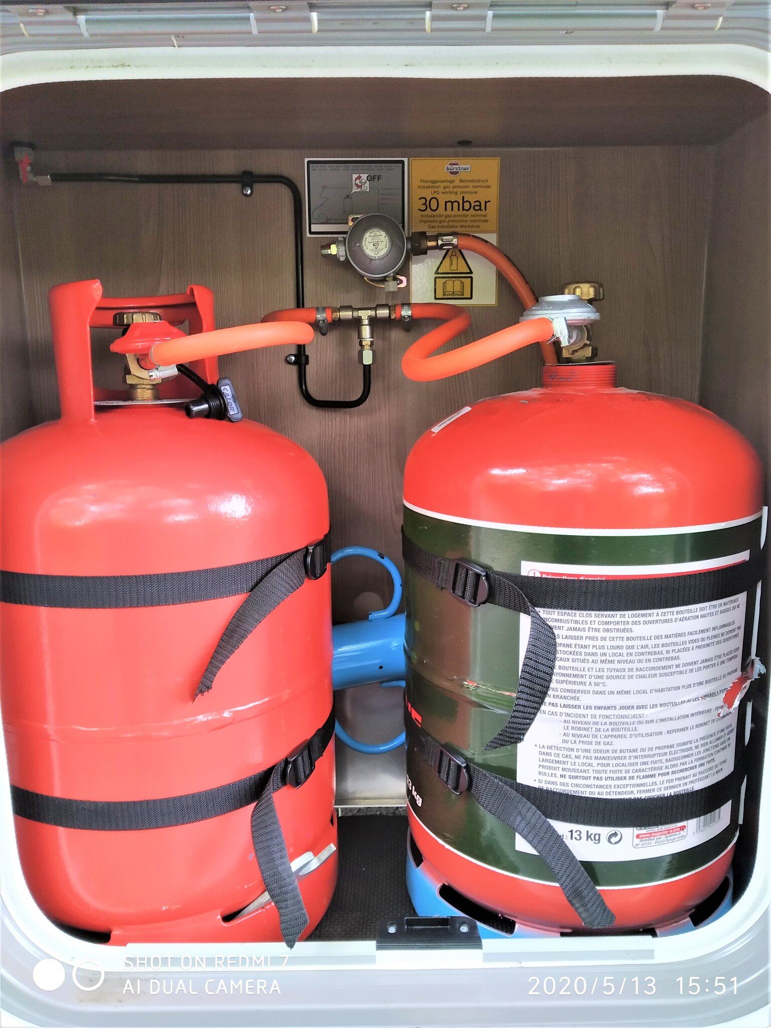

So someone has changed a 2 stage 30 mbar leisure vehicle regulator for what looks like 37 mbar single stage regulators without any over pressure protection.
Good luck with any insurance claim in the event of a gas related claim if the assessor knows his stuff .
Do you mean the regulator screwed to the wall that is not connected?
I had two simple regulator's connected to individual bottles and only ever used one at a time.
The bulkhead regulator. If you get a French bottle, and the French pigtail will fit The bulkhead regulator. At least is does on mine. I have an underslung tank, but carry a French propane bottle in. The winter as a back up. Make sure you ask for Propane, as a lot of French ovens the bottle fits inside the cooker so does not suffer so much from low temperature.
Those simple regulators as you call them aren’t actually up to the requirements of the leisure industry standards.
Single stage is a much more unstable pressure / flow to your appliances and they don’t have the required safety protection with over pressure protection.
