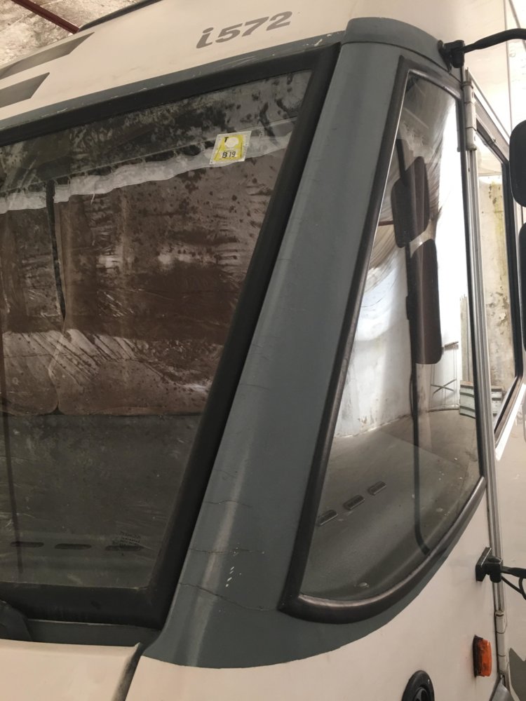

Hello everybody,
I would like to ask if you could advise me on how to fix the "A" pillars cracks shown in the attached photo. My gues is that they appeared due to the torsion of the camper's body.

that looks like a structural failure and needs proper investigation
I'd try and get behind the damage probably only fibreglass on that bit see what is behind the crack if anything - if feasible lay up some more mat behind damaged area - once done that cut v shape in exterior cracks and fill with gelcoat filler - but thats what i'd do if it was mine

Are you sure it is fibreglass. I would expect to see some of the glass matt threads in the cracks if it was and the colour would probably only be in the gel coat finish. Might be plastic and non structural itself but as already suggested could well be a sign of something more serious and structural going on behind it.
Question for the Funster experts, could it just be old vinyl wrap that's shrinking \ cracking? I've no idea (but what's new)!
looking just at the bottom crack, it continues the line of the side window right round to the windscreen. there may be a steel box section frame beneath the outer skin, but i suggest that too is flexing. the strength to maintain rigidity seems to rely on the bonded glass windscreen
A previous repair failing?
Trim/decal above side window appears to have aged differently to that above windscreen, maybe a clue??

It looks to me as if the there is horizontal cracking all the way up the A-pillar and not just at the base.
It also looks as if the pillar is covered by vinyl plastic so if the van is a good age then it could have sucumed to the effects of UV, heat and weather etc by drying out and cracking.
Bit late to the discussion, did you ever get to the bottom of it? I think you're right about the body flexing because from what I understand a lot of A-Class motorhomes have the A-pilar made out of wood :Eeek:
