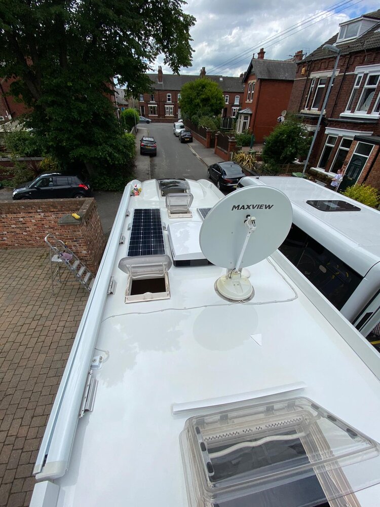

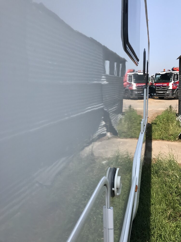

Has anyone done their motorhome or had it done
A customer of mine who‘s daft about his Ford Cossie suggested “we” did my Comanche using G-Tech Ceramic coating, this was done early last year and took 3 of us 4 days to do and ran out of time to do the roof 🙁.

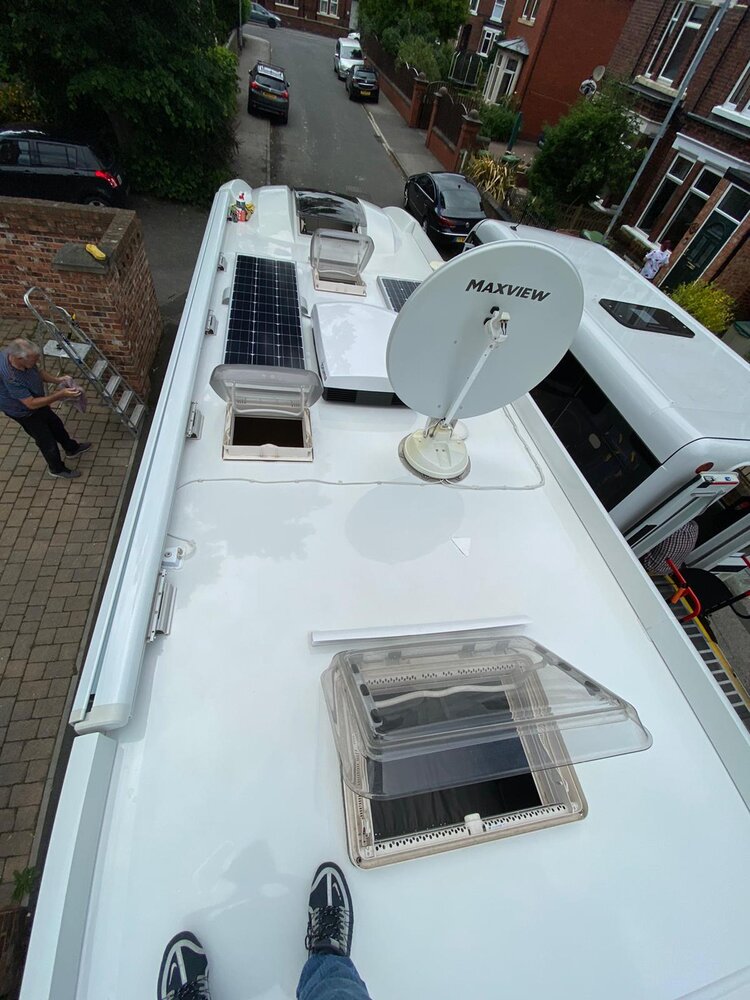

So on tuesday this week he suggested I get some of this to wash the van and do the roof and wow, literally took us 2 hours
and here are the results
then I used it as a top up on the bodywork which once again took less than 2 hours
i’m chuffed to bits as that’s it for another year

So basically you just have 2 products, a wash followed by the coating. Had the roof had any sort of coating on before?

no, the roof had not had anything done to since i purchased the motorhome brand new in Sept 2018.
Last year the main bodywork took us 4 days to wash and machine polish, then apply the ceramic coating then buff up. I topped that up on tuesday this week after doing the roof just using the C2 spray which took around 80/90 mins including a wash.
The roof was filthy, I wish i’ve taken a photo of it now tbh, we washed it then sprayed it with the C2 and just gently rubbed it on the roof, very easy and I mean easypeasy which took 2 hours, the washing of the roof and getting into all the nooks and crannies took about 90/100 mins and the C2 literally about 20 mins
now it’s all been done it’s just a matter of washing the whole van inc roof and then wiping on the C2 each year in my case although Matt did say it lasts approx 5 years
