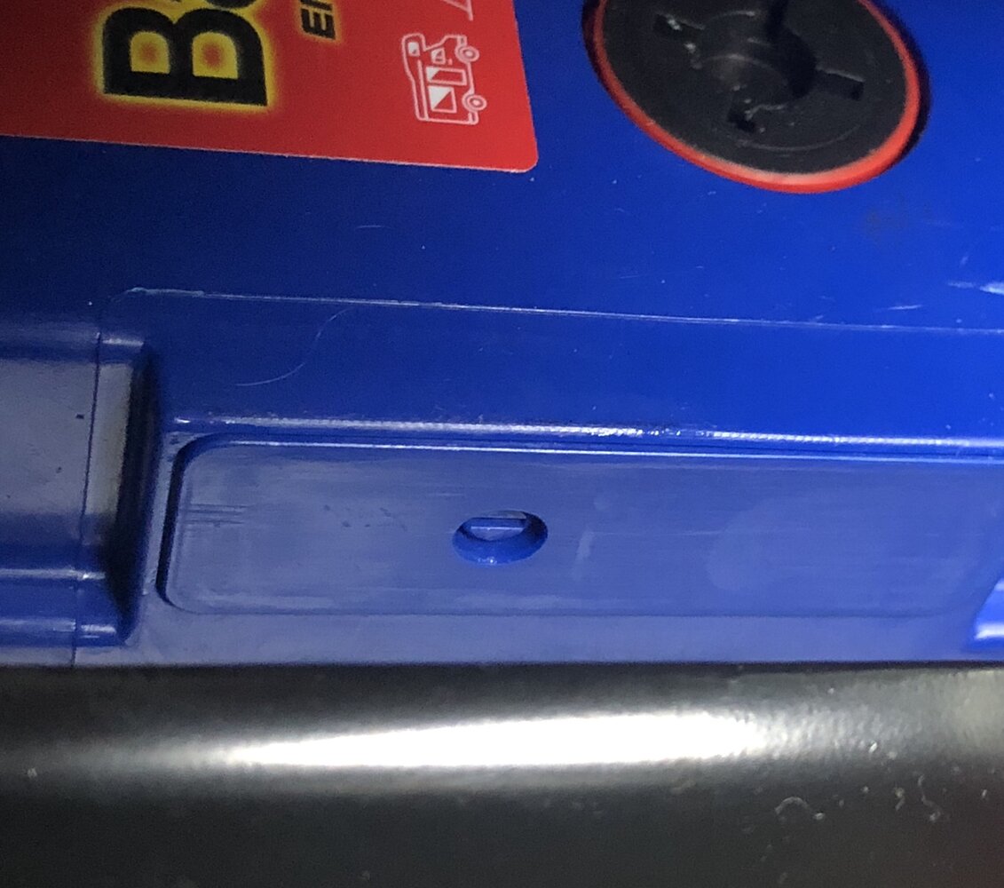

Checking out my battery install I see that a vent pipe has not been fitted on my Banner 100Ah battery.
So I will fit one but notice that the vent hole has something already in it but I’m not sure if that is a plug or a pressure release valve that the vent hose and fitting will clip over??
So the questions is - do I remove the central “plug” from the hole (as shown in pic) or do I fit the Banner vent fitting over it?
I can't see anything in the pic that resembles a vent?
Its the small hole with what looks like a flat screw slot in it, approx centre of the picture.
I was told that the newer batteries did not require venting
Normally the vent holes are right at the top rear corner on each side with a black plug in them. That is not a vent in your photo.
That appears to be a split post used to retain the cover. It is definitely a fastener and not a breather or vent.

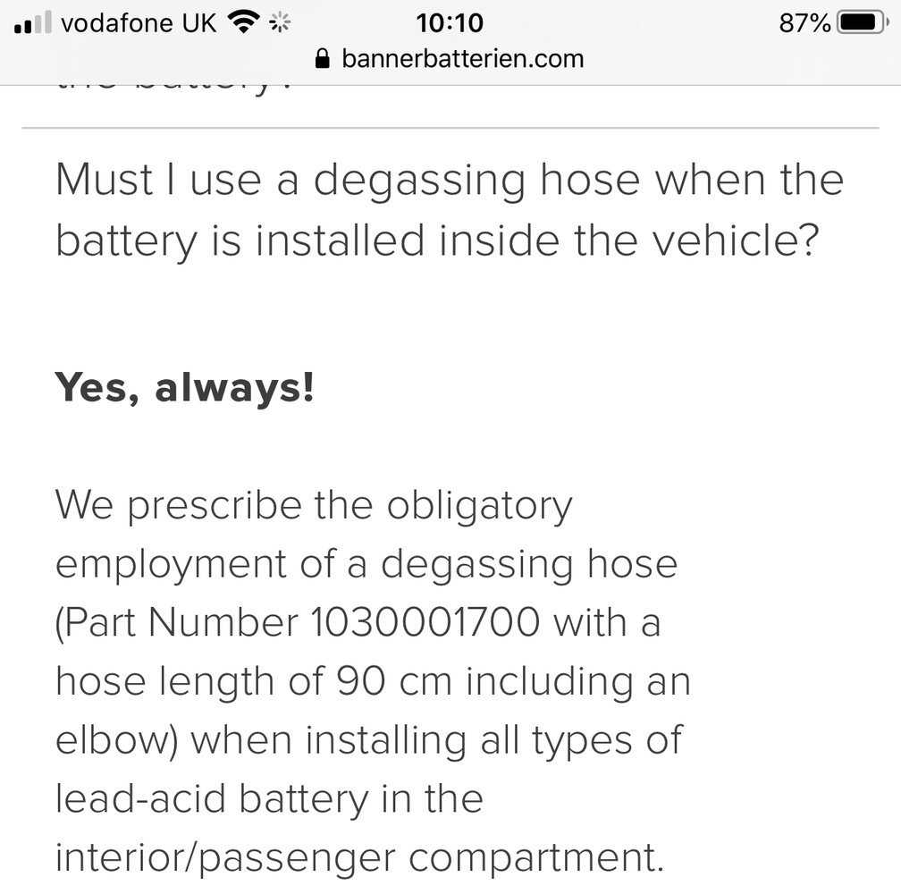

I disagree, I believe that that is the vent.
In fact Tanya batteries specifically show the vent on their website -https://www.tayna.co.uk/leisure-batteries/banner/95751/
Here’s the pic of the close up on their website.
And as for whether a vent should be fitted, Banner (on their website) say “Yes - always when fitted inside a vehicle”

I think that is going to be the vent hole but not sure how it works, it might become clear when you buy the dedicated Banner vent tube,

Ok problem solved - spoke to a battery dealer and they advised....
Yes - that is the vent hole
No - don’t remove the plug as it is a special valve; the vent fitting pushes over it into the hole.
FYI - This is for a Banner 95751 “Energy Bull” Leisure Battery.

I disagree........ not utter tosh at all!
Banner have said on numerous places on their website that a vent should be used.
And referencing the Technical Documents from their website it states “...when installing indoors always use a degassing hose, which in an emergency will conduct gas outwards”
So to use shouting language....
“ALWAYS USE A VENT TUBE IF INSTALLED INSIDE A VEHICLE”

Banner AGM's do have a vent and it's recommended that you vent them, the vent has a pressure release valve so it's not an open vent.
