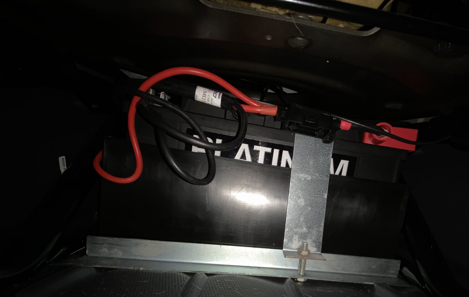

I’m not sure what sort of battery we have (see photo, its well hidden) we do have a solar panel and there was a bit of sun last night for a couple of hrs.

Its a Platinum but don't know size etc, if you have a solar panel and a bit of sun don't be fooled by the reading of battery voltage 12.5v for example is a combination of the battery voltage and the solar charge voltage so the real battery volts is certainly lower than the indicated 12.5v.
