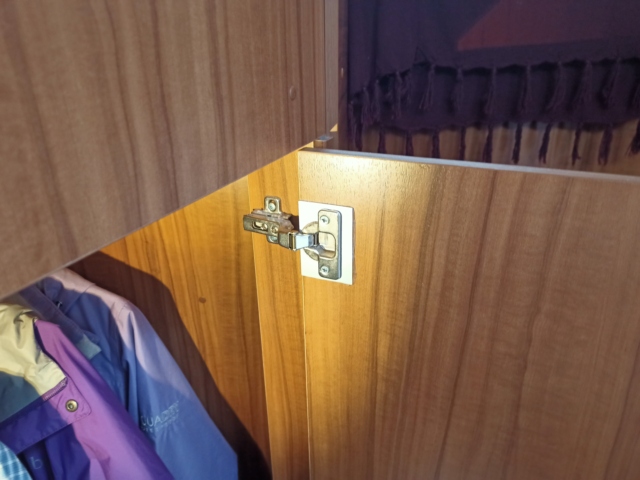

Not had our van long ( well not able to use with Covid ) just been out for a trip and over the course of the week two of the cupboard doors came away from the hinges....... its obvious that as the doors are chipboard, the screws have pulled out with use. Has anyone had this and what is the best way to repair???

Glue matchsticks in the hole and re-fit door
I'd use a two pack epoxy glue to stick the matchsticks in as when it sets it's really strong but has a slight give
Araldite is a really good solution and if you put a very small pilot hole in when hardened screws will hold in it well👍😊

I use epoxy glue a lot as it also fills any small gaps. I do just use any make I'm not sure araldite is better than any other. From memory I think Toolstation were the cheapest.

I had the screws pull out on one of my under bed wardrobe doors, door construction is thin ply with a polystyrene core. Because of the polystyrene the glue method wouldn't work so I used some anodised aluminium cut to suit the hinge and glued with expoy to the door. worked a treat.

If they are kitchen cupboard hinges then you can get repair plates.

Hafele a German company do them. The eBay link was just easier to find.
I just bought some Anodised Aluminium cut to size from eBay & used a hole cutter for the big hole & drilled a couple of pilot holes for the screws.

+1. Done it at home and in the m/home. I just used pva glue, rammed matchstick and a shaving of one into hole. Wait until dry (10 mins ir so). Shave flush with surface using Stanley knife. Refit bracket.
Just done a door hinge repair and repaired the stupid fixings for the round table in an an Autotrail. Used 2 part epoxy putty- solid as a rock.
Ive used the above plugs too & got them from a local joiner. I did glue them in too to be on the safe side & they work

I used these recently to repair a kitchen cabinet hinge mount, excellent and cheap !
Those are excellent but for the cupboard side of the hinge rather than the door side.
