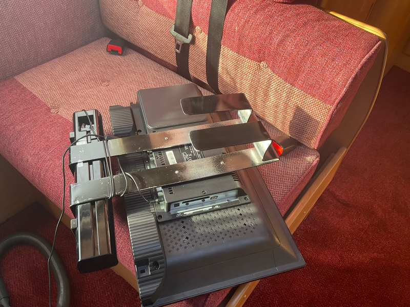

Tv bracket now made .
it is removable and hangs on the top cab bunk bed.
but can be hung over anywhere I place a rail.
plugs in to the under cab seat cigar lighter sockets. Under either seat.
a tv aerial is within easy reach as well.
will be removed and packed before travel even though I can not see the screen while travelling .

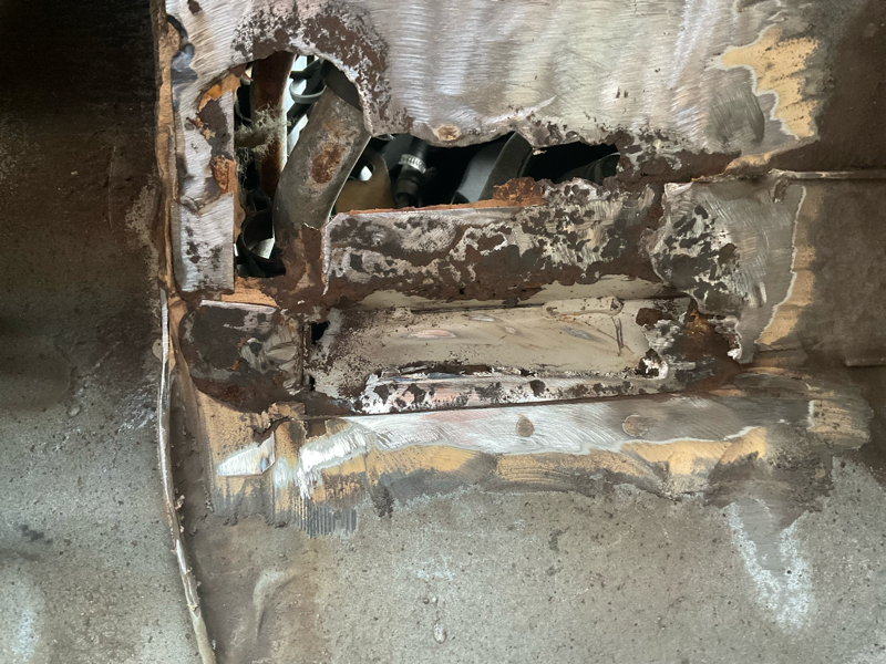

There’s lots of room underneath to weld on hands holds as well. After I weld up the wheel arch .
Well that went well.
managed to get it all off and welded a plate but only one side.
the inside is under the spot welded into position battery tray.
may have ago atbplating the inside as well but I don’t think it will need it.
then blacked it all in. I know it does not go well
with the mot testers but there more than welcome to have a knock about with what ever.

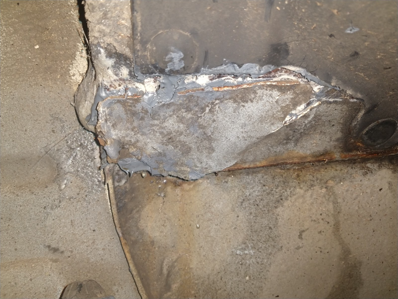

Tackled the rust yesterday this was under the GRP and mastic patch.
I had to cut out a lot more it if.
looks like it has been caused by the overflow or breather for the battery.
a plastic tube from the top corner of the battery and was sitting above the damaged bit.
Now replaced the tube with a long one that clears everything.
all the rusty bits were removed treated with a rust fluid and welded a new plate .

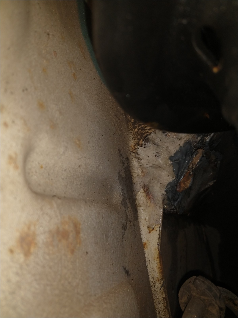

The front near side brake spring is rusted. How on earth you can see them I just don’t know.
anyway replaced now but as I said there must have been a past history with the mot centre and the owner .

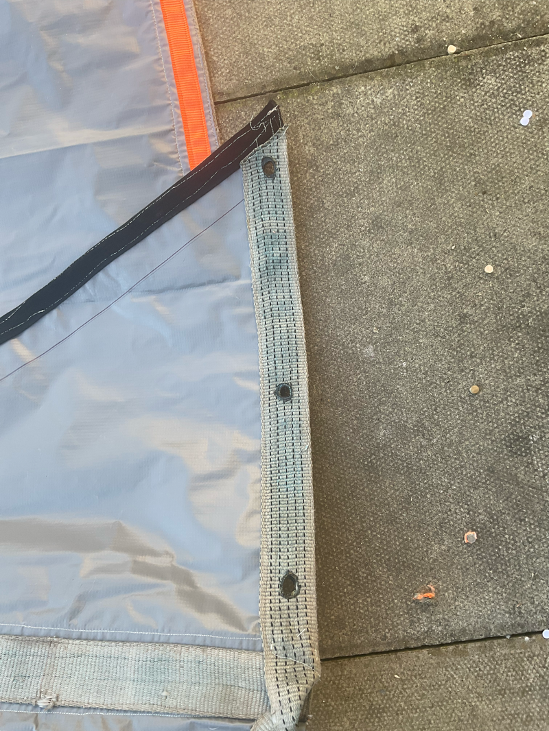

At long last today I finished the the side of the draft excluder which clips on the side of the van while the awning is up
I managed to put some webbing on it both sides for superstrength and then cut and burnt the holes through where the tent pegs pin it to the ground.
And it’s now ready to be threaded on and used . I attached a loop either end at the top so as to make it easier to pull along.
attached to it is the wheel cover that will be held up with some adjustable and removable. Suckers.
With the holes already made …..Each time I put a pin through it will be the same hole and cause no damage to this draft skirt . and should get a fair bit of use out of it.
Unlike one I had before that there were that many tent peg holes in it. There was not a lot left of it.
then the slightest strong wind and it would tear a little more.
