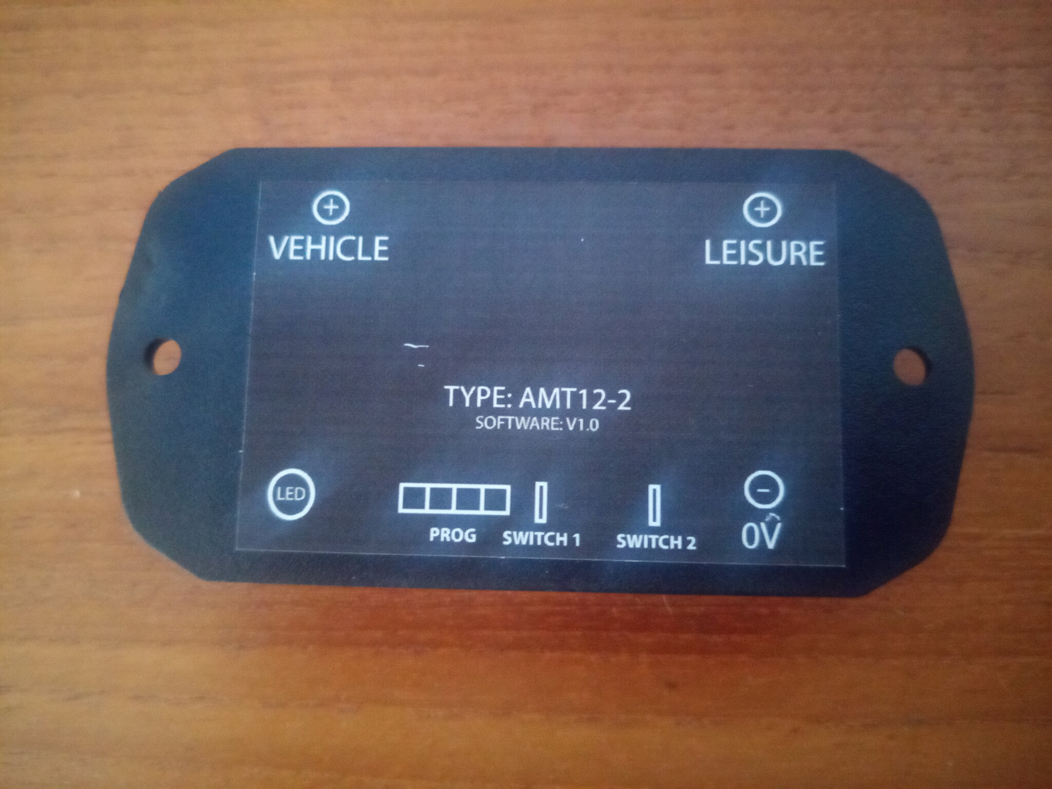

Thought I would add some comments to this thread ref the AMT12....
The current AMT12 is the AMT12-2. Photos below:
View attachment 596251View attachment 596252
The key difference between the AMT12-2 and the original one is the style of connections. The original ones uses 6mm studs; the new one swaps those to Feston (spade) connectors.
The instructions do need some "Plain English" re-writing, I would agree. On the plus side, the instructions ARE correct when followed and these devices really are "fit and forget" once setup.
Now Switch 1 and Switch 2 ... These are not switches as such but connections. You CAN connect switches to them to expand the devices usability however.
Switch 1/SW1: (next to Green Plug) This is a connection that allows to to select which one of the 8 preset programmes you want to use, following the (hard to follow) instructions in the Instruction Sheet. You chose the Programme depending on the type of Leisure Battery and Type of Alternator you have:

SW1 is only ever used for initial setup of the AMT12. The only time you would typically use it to reprogramme is if say you fitted the AMT and then updated your Leisure Battery from Lead to Lithium (so change settings from 1 to 2, or 4 to 3 for example).
Talking about Programming, the 4 pin Green Plug can be used to reprogramme beyond the factory presets. It is possible to buy a USB lead to connect to your Windows PC and run the Ablemail s/w to programme it. Or on the later versions, a Bluetooth Module (ABB07) can be fitted to the plug and a Smartphone App used to reprogramme. You can use the Windows Programme or the Windows App to Monitor as well as programme, which could be of use, but generally is not needed by most folk.
The other connection - Switch 2/SW2: (next to 0V) - is something that can be of use post-installation. If a +12V signal is applied to SW2, the AMT12 is forced on and the preset programme is ignored whilst SW2 is high. It still has an on/off cycle, but is predominantly on, and does not rely on a certain voltage to be enabled.
This can be useful if you are in a situation where charging is poor (maybe over-winter in storage?) and you are ok to use some of the spare capacity of the Lesiure Battery to trickle the Starter to avoid it getting to a very low level?
