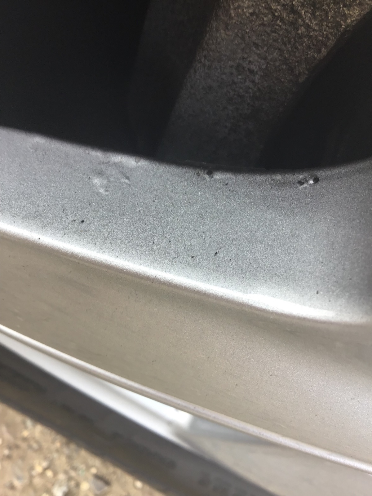

My take for what it’s worth would be don’t bother. Over the years I have had nothing but bother with Motorhome alloy wheels and find them more trouble than they are worth. It all started when we bought a Burstner Elegance back in 2010, it had lovely diamond cut alloys, within 6 months they started to develop white veins under the varnish. Burstner kindly replaced them twice in just under 3 years, each time telling me the issue was resolved. We then bought another Elegance, same again 3 sets under Warranty. Then a N&B Flair, not such a nice finish as the Burstner alloys but started to pit after 12 months, again replaced under warranty. Moved to our first Morelo and again same issues, the alloys were the same model as the Flair and suffered the same issue. Morelo replaced under warranty and they were good for 18 months. I complained again and Morelo offered 50% contribution to replacement. On ordering my first Liner I opted for chrome wheel trims, would never have alloy wheels again.
The pictures are of the Morelo ones after 12 months of use.
