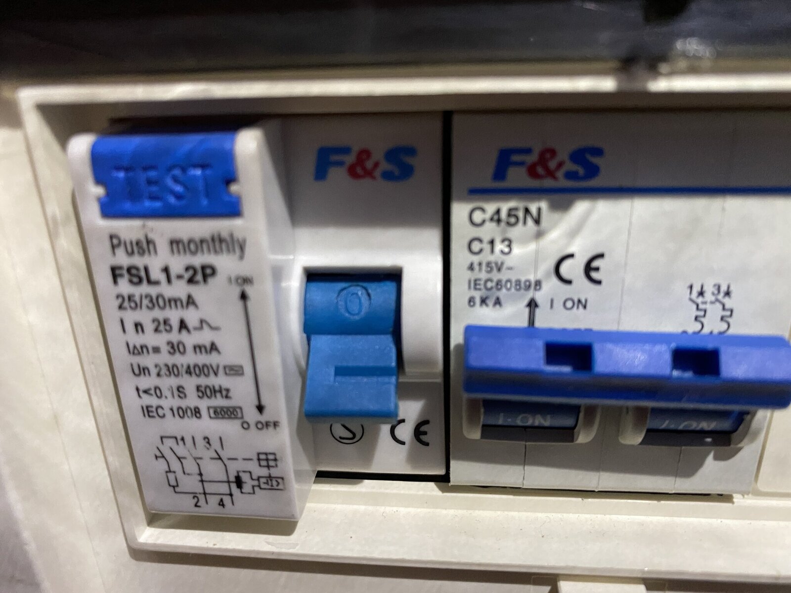

Next question, how do you know what the supply rating of the hookup post is? Usually you can see the trip switches, and the amps rating will be written on it. With a B or a C in front of it. So if it says B10, B13 or B16, or C10, C13 or C16, then it should be OK. If it says B6 or C6 then it will probably trip.Only if your on a EHU and have a minimum 10 amp supply..
