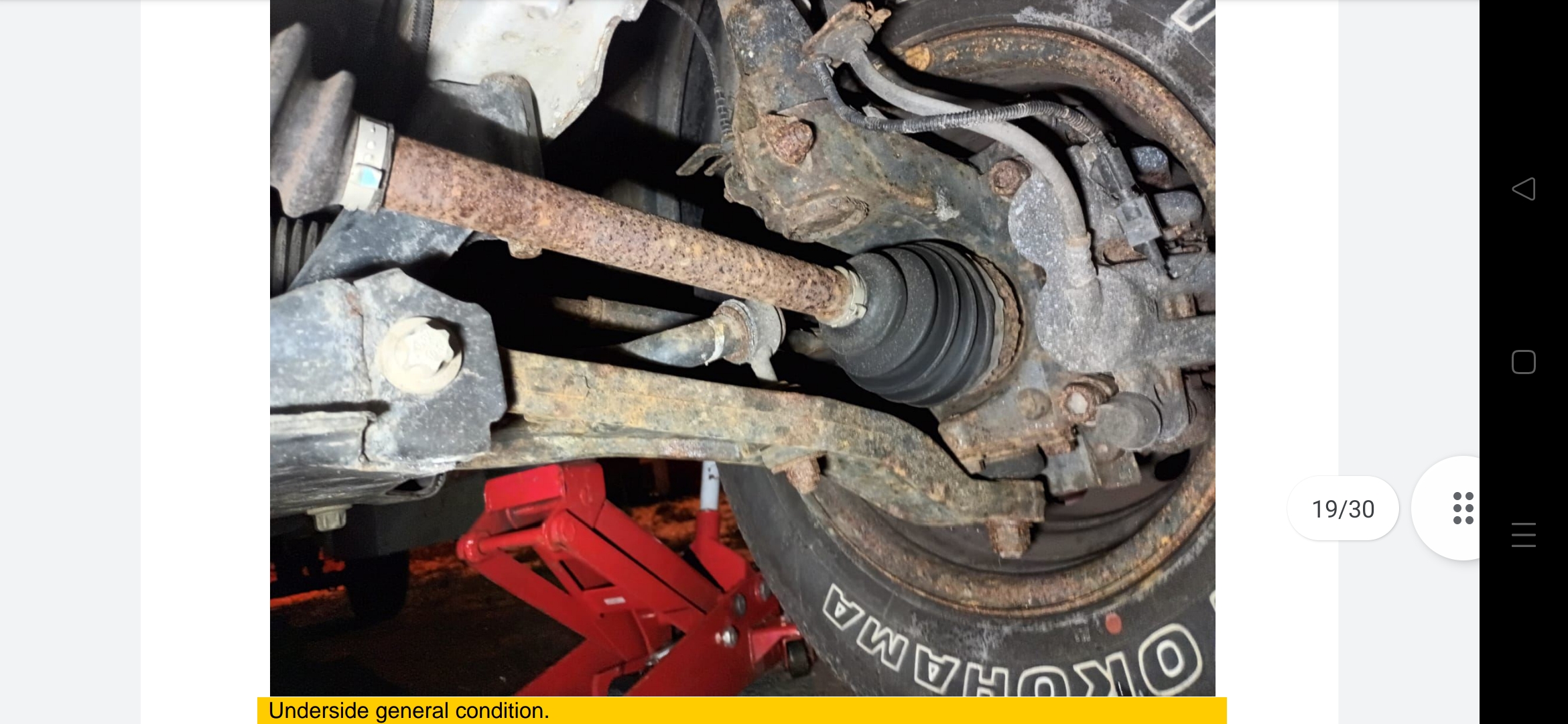

Hi all. I need a bit of advice if anyone has any. I'm close to buying a 2012 Rapido after agreeing a price I'm happy with. I just had the results of the AA inspection. Can anyone please share they're thoughts on this? I'd be really grateful. For the experts out there, what would you do?

My thoughts, unless you have a mechanic mate run and even then I would walk away quickly.
Was going for a test drive next week but noticed no smoke when the engine was on during a viewing.
Smoke under load as you drive it, not idle. If suspension components are rusty maybe sea side and winter salt not washed. I would keep looking. It could be a expensive experience.

That is additional information. A vehicle inspection in under an hour in the dark would not be worth the paper written on. Clearly no compression test and how did he know what colour the exhaust smoke was. V poor.
My boat surveys have taken between 3 and 4 hrs with a sea trial on top.
The owner has only driven it on very short journeys since August when the MOT and habitation check were carried out and has never noticed any blue smoke at all. Maybe it only starts when engine is a bit warmer, I don't know.
I would be taking it for an Italian Service once it was properly warmed up. Low gear, high revs preferably up a hill. The smoke could be oil built up in the exhaust from valve seals on their way out.
Get it hot, plenty of revs and if it still smokes walk away.

If you really like the van, it all comes down to how much you can get the price reduced by. A recon engine and all the other bits and pieces professionally fitted could be 5 - 10 grand.

Having spent My working life in the retail motor trade we welcomed AA inspections. First is the blue smoke, that is a sign of oil passing beyond the piston rings and been burned off and the fact that they shortened the road test says to me remedial work is required in the worst case it means removing the cylinder head, sump and pistons for further inspection certainly not a cheap job . Exhaust silencer corroded could eventually mean replacing it, It’s difficult to comment on corrosion on the suspension as yes they do go rusty but to what extent bearing in mind it is steel and some suspension parts are pretty robust and can look to a layman worse than you think but I would speak to the AA engineer and ask to what extent. Personally alarm bells are ringing and I would be having second thoughts and remember the reporting engineer is professional at what he does.

Take the advice unless you can have a cost of repair from someone who is willing to fix the van or a reduction in price to well cover the cost and hassle walk away. An engine rebuild and fitting is between £3500 and £5000

Thanks again for all the input. It's all really helpful. The owner has responded with surprise and has never noticed any blue smoke but he only has very small drives here and there. I've sent him some of the photos AA sent over which are just photos of the underside. I've put in a complaint with AA. Not sure how that'll go.
I don't have anyone that I trust enough with vehicles to have a look at it so would have to go the pro route again and now I'm £200 lighter, not sure if I'd do that. I'll have to have a think about it all. Thanks again. I'll leave some of the photos AA sent in case they are of interest to anyone. There were other photos but these ones relate more to the amber and red items reported. It was a green tick for anything else. Happy to email a copy to and experts that might want a look over ...
