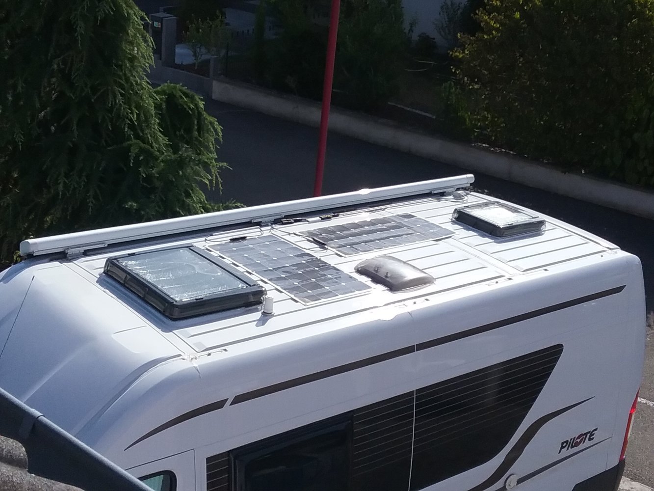

I've had rigid panels on coachbuilt MHs and campers but on our last 2 PVCs I put semi-flexible ones, neither type have given us any issues at all even after many years of use. The last PVC had a 60w panel on for over 3 years without any signs of physical or output deterioration, hence my decision to go with 2 x 100w ones on our current PVC (its got an all-electric fridge) after much debate/comment/advice (delete according to your view! :D) on this forum.
The only concern I have is that, made by others too, of semi-flexi ones getting overheated as there's no proper air gap on a coachbuilt/a-class roof to prevent this, whereas the roof of our PVC has a corrugated structure so no worry about overheating.
If I could satisfy myself that putting semi-flex panels on a totally flat roof wouldn't cause any issues I might do so, otherwise I'd go with rigid raised up off the roof.
We had 2 x 100w on the last van for over 4 years no problem, and the same on this van for a year so far, we are in some hot temperatures and cant fault them. (y) Bob.
