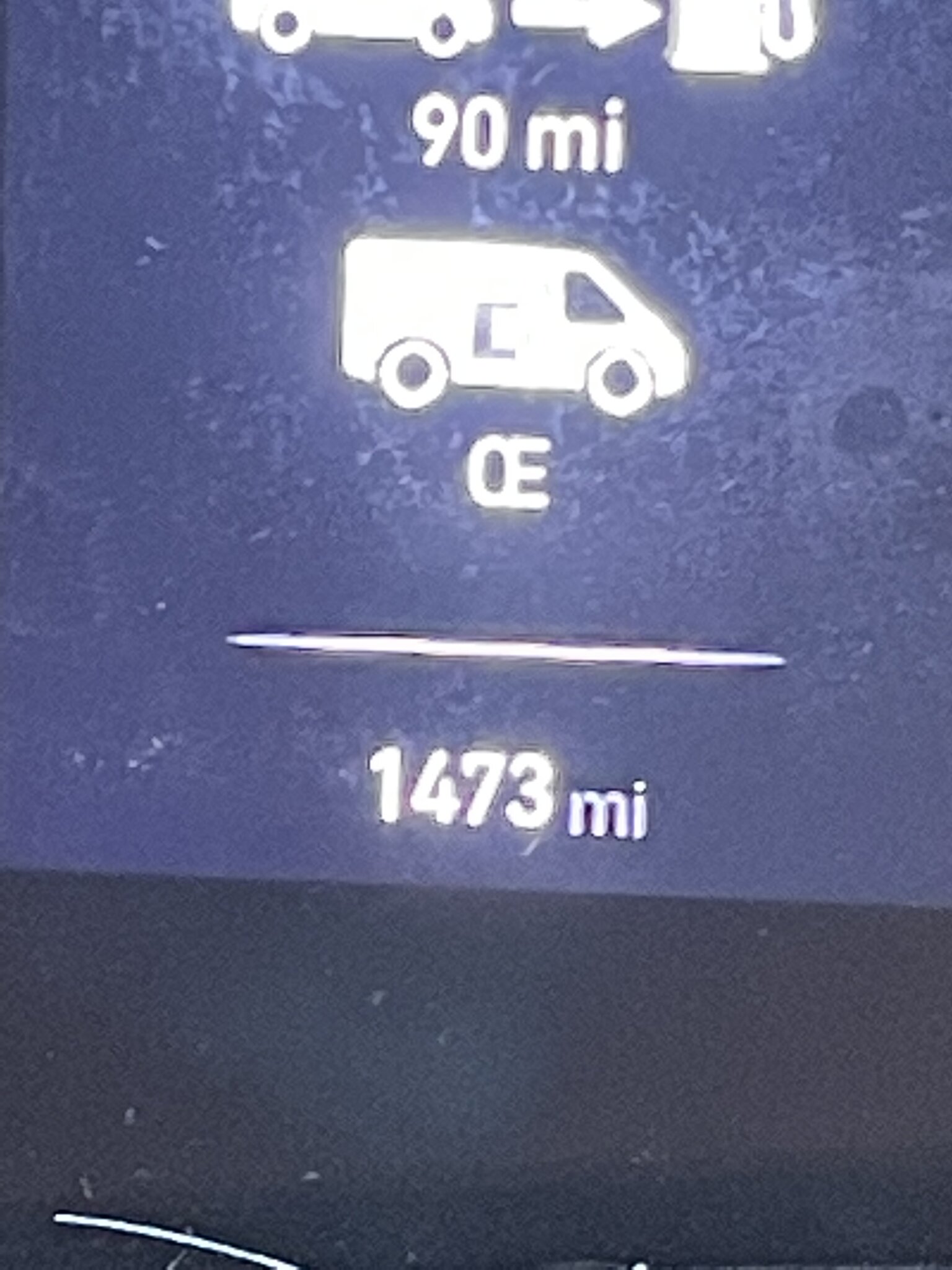

our dash display shows no current fuel [instant mpg] on dash display does however show some random letters or emblems this is uconnect syst and the radio screen will display the readings [dont look correct though] fiat have now spent several weeks trying to resolve this on our new van. interested if anyone has or had same problem

I have this problem on mine. Supposedly fiat are having a software re write done but no progress so far. North East Truck and Van at Carlisle did a software update for something or other and made no difference. Been waiting a long time now.

So no instant mpg reading on yours ?? If this is the case I would like to exchange info for reference if thats ok
No instant or trip 1 & 2 average
On a couple of occasions they have worked for a few seconds only
Input for all 3 from same source
Told it is a software rewrite by Fiat to sort it. I was first with this issue at north east van and truck with issue but they have now seen more with the issue

Mine is doing the same! no current mpg and no average in trip A or B....also getting airbag and check parking brake warning light. Alarm and tracker fitted. Had a software update the other day which made naff all difference apart from resetting my digital display to Italian!

Took tracker out and then went to fill up with fuel. Still same issues, nothing or random symbols where current mpg should be

Yep thats def same seam strange only appears to have affected just a few vans and different builders. So we have to keep badgering fiat for an answer. Almost a year for me now
