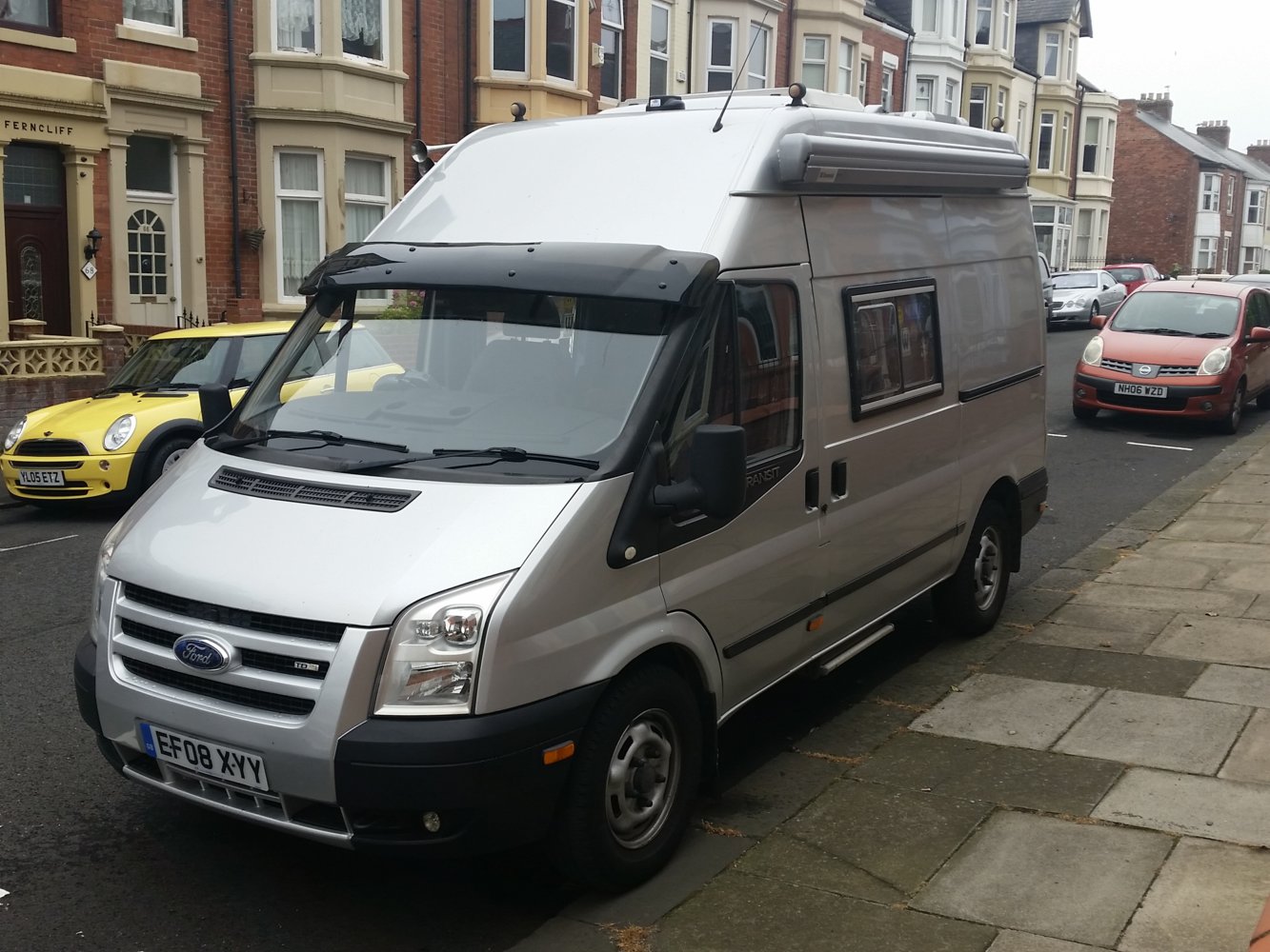

Not sure about the new transits but even the mk7 vans are imo not the best vans for converting... the van sides vary in width from floor to roof to much..
If its bought for converting it would be handy if it came with the ford svo (special vehicle option ) of the auxillary fuse box but few are unless specified at order... it allows wiring in additional features without having to mess with any of the vehicle electrics..
I have converted a mk7 dont reckon i could recoup my money on it... everything i fitted was new , and very much to my spec at the time.. a bit of a one off and some of the work like installing bunk bed was a bit unusual in that type of van conversion..
You dont sound overly confident about taking on the conversion ...and if its your first conversion it would be a steep learning curve...
Plenty of advice available on here ..
Heres a piccy of mine..
Good luck with yours..
