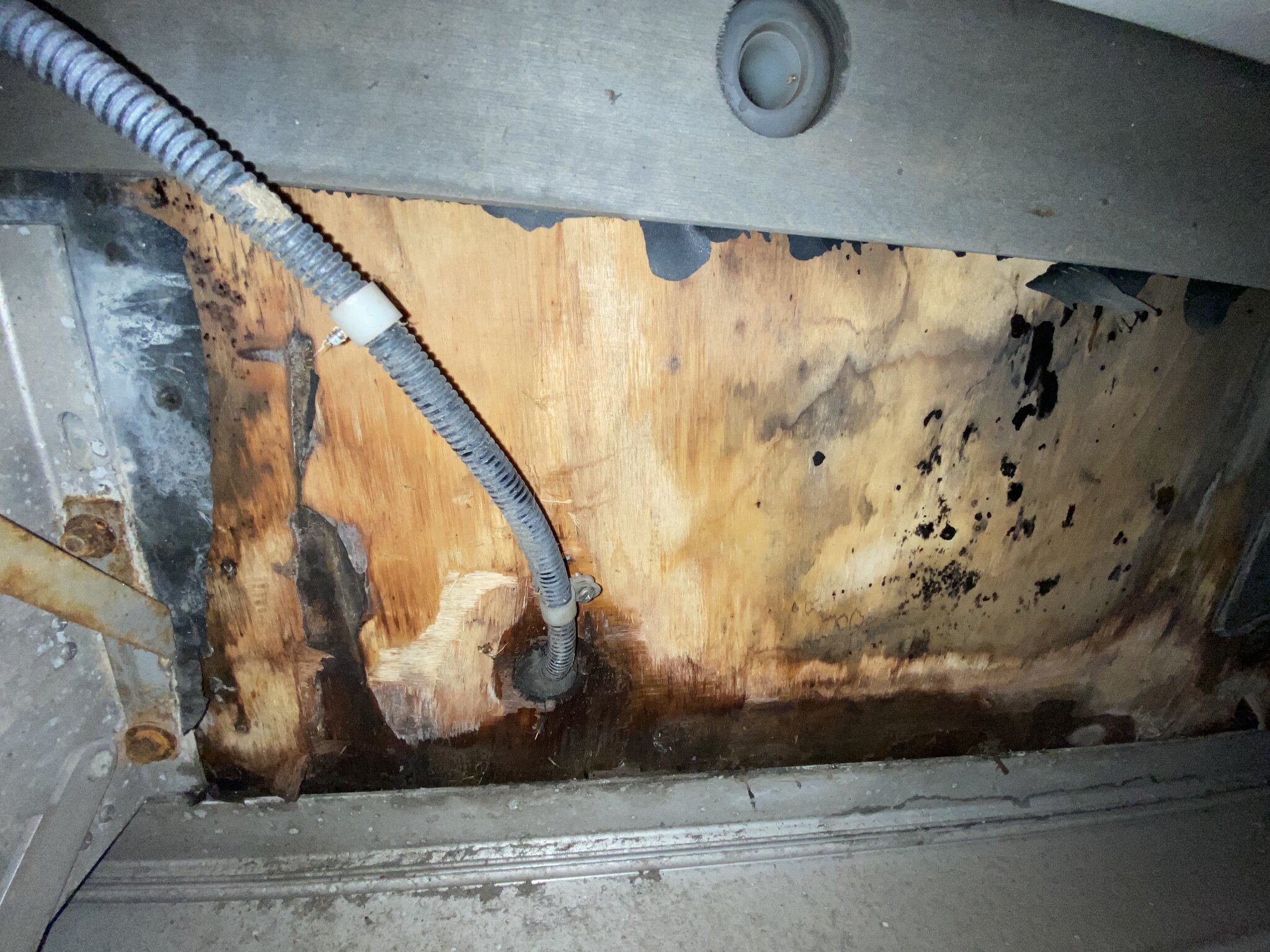

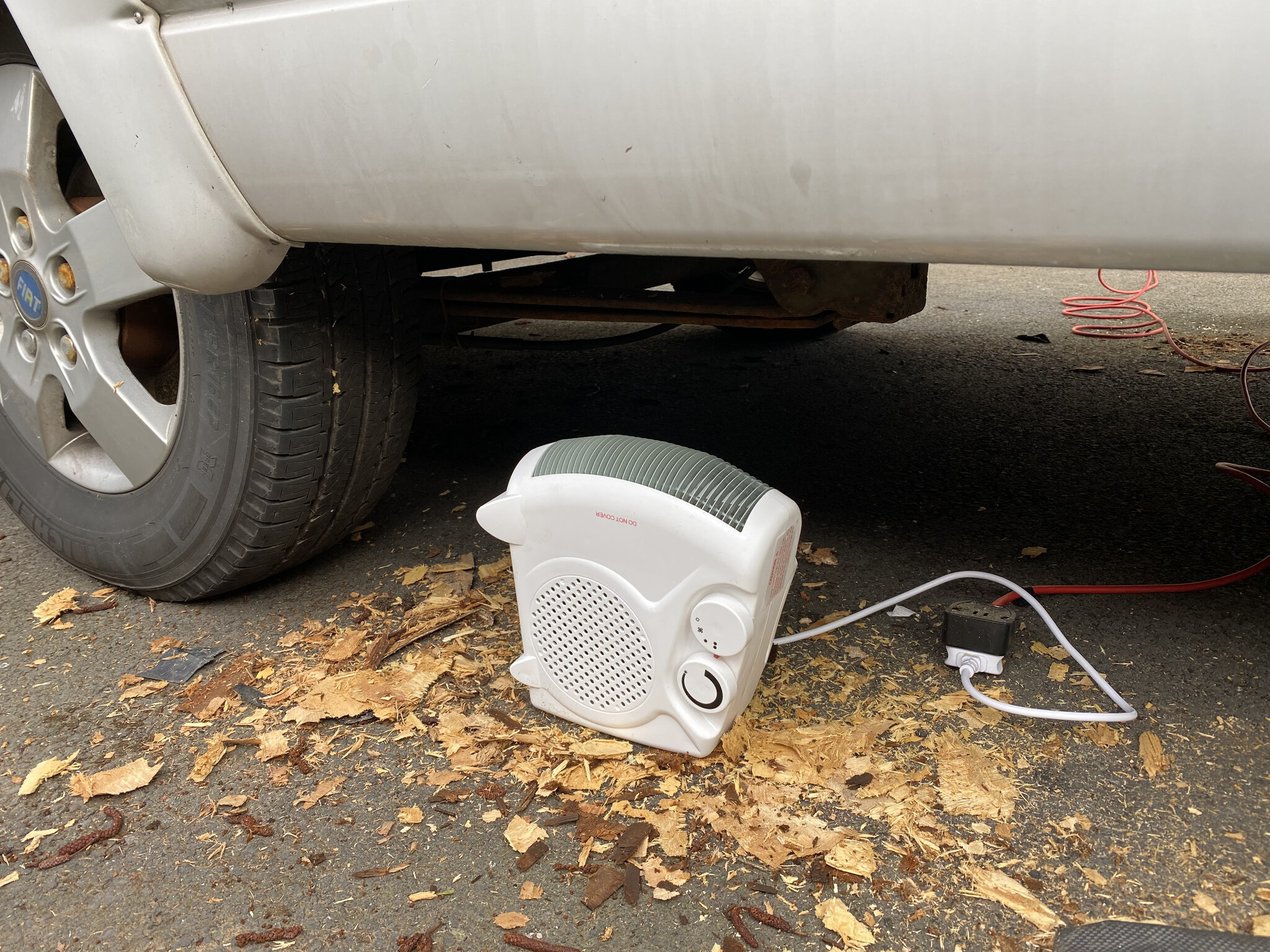

The plan for today is to remove all the wet wood and start to dry it all out ,also completely check the underside of the motorhome for anymore floor problems .

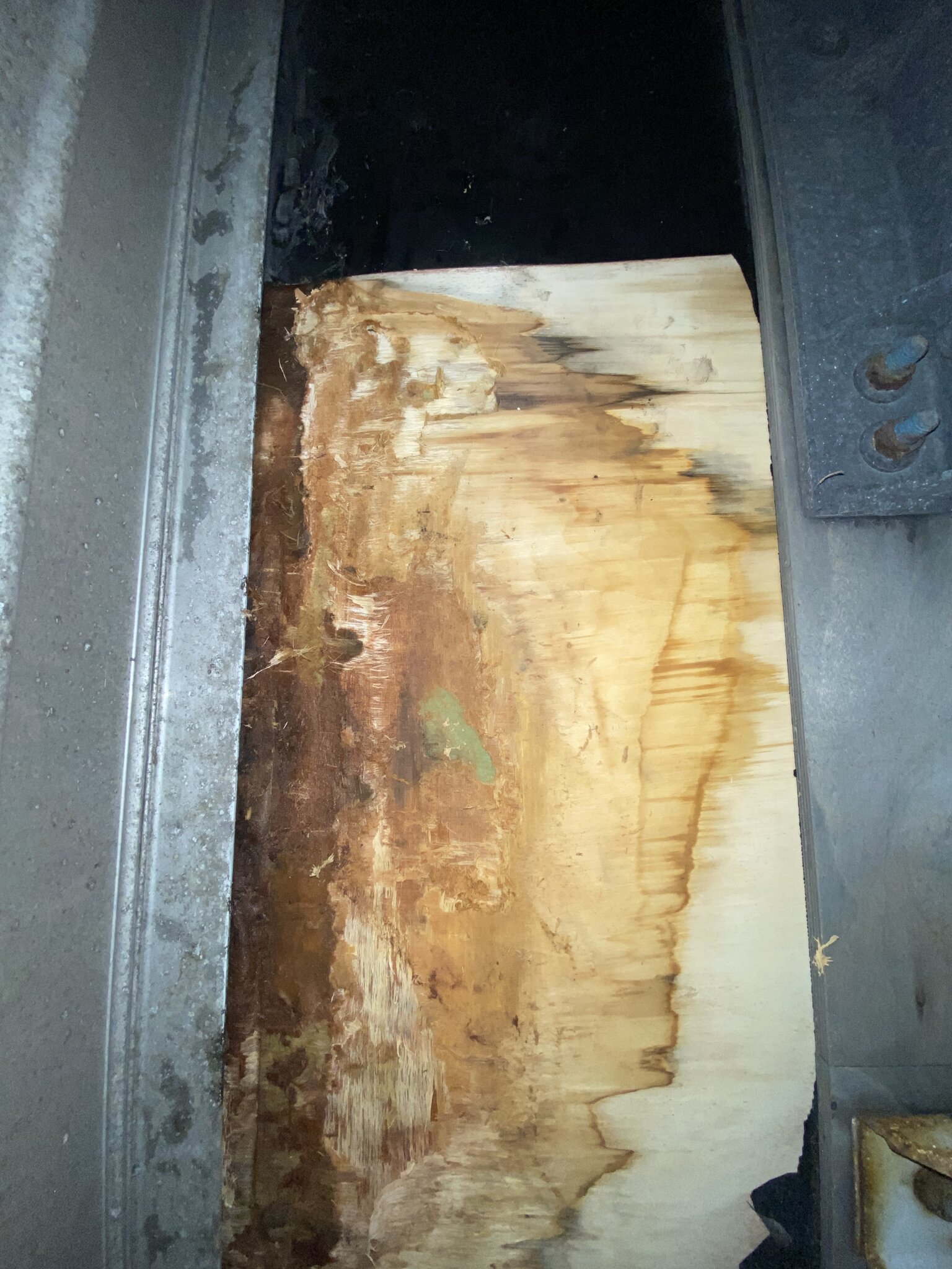

After a full check of the underside I have found another damp patch . Front corner behind the drivers seat . This one has gone a bit further in towards the middle of the van .
Ironically it’s under the internal water tank but has rotted from the underside 🙈
The plan is to make sure all the damp wood is removed to let the problem areas dry out .

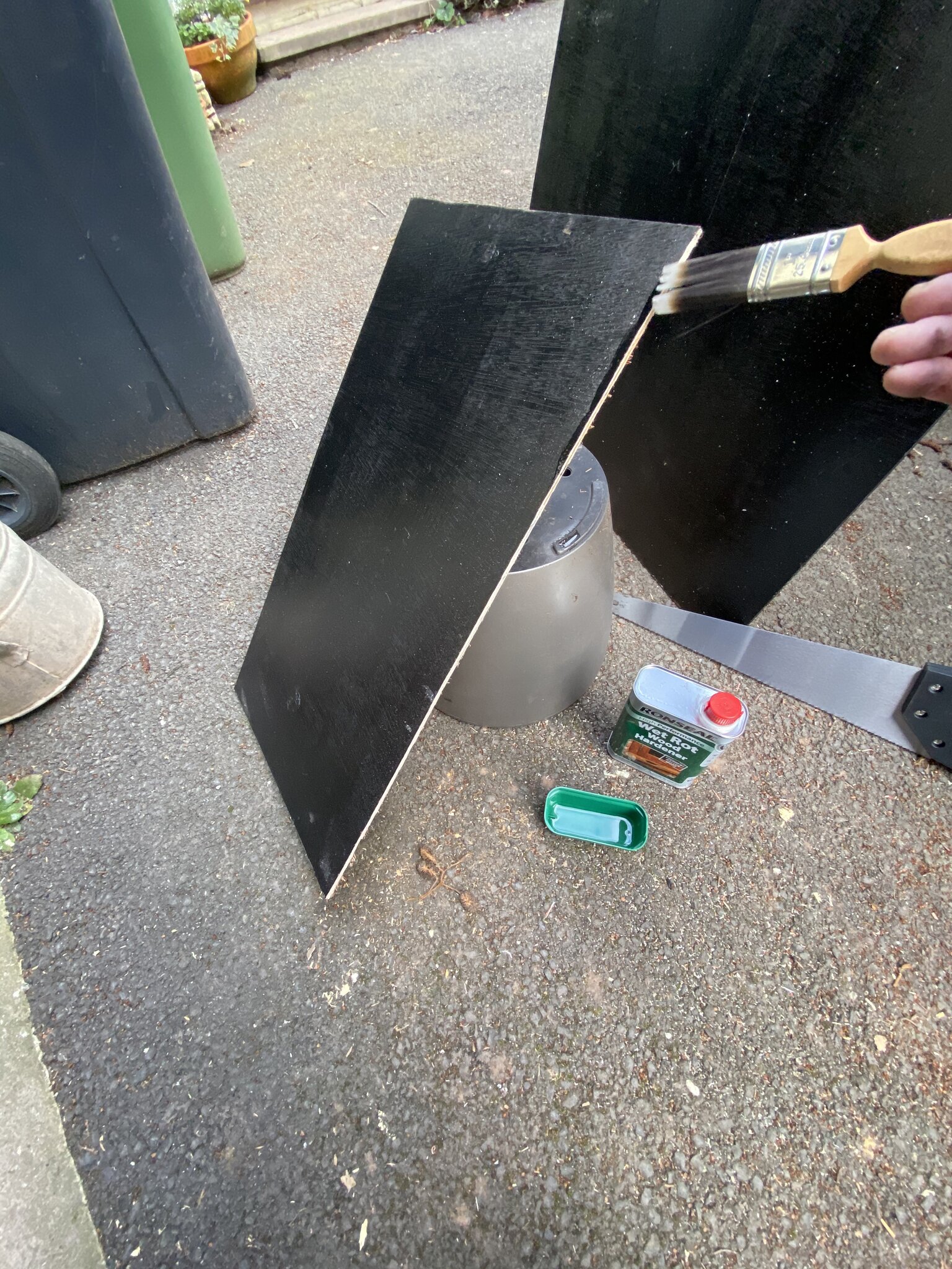

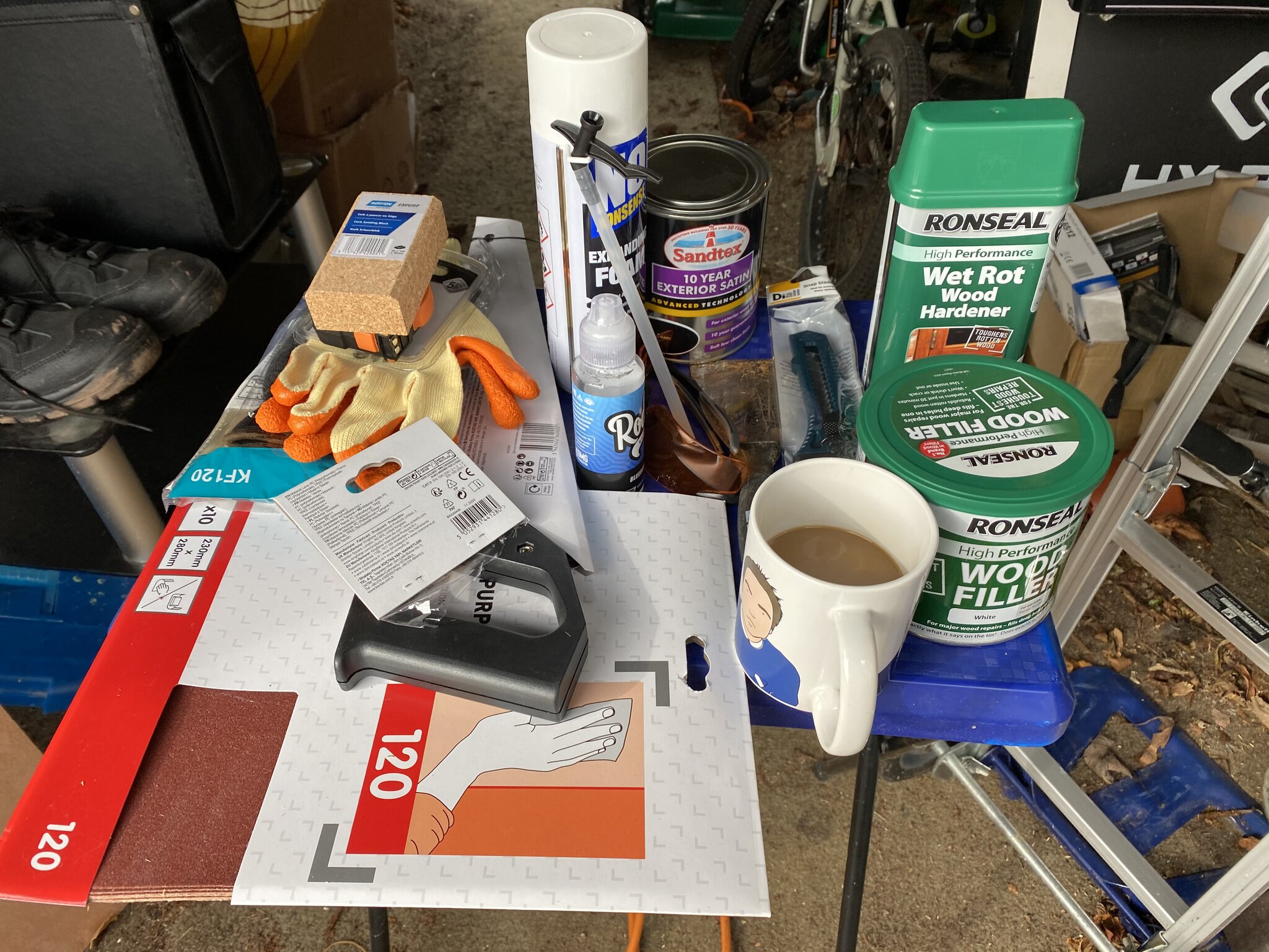

I will then use the wet rot wood hardener to treat the wood , then wood filler and then re ply the surfaces . It looks awful and I don’t expect to make a very neat job but hopefully it will stop any future problems .

Ronseal Wood Hardener £7.99 in Screwfix and they are part of the B&Q Empire.

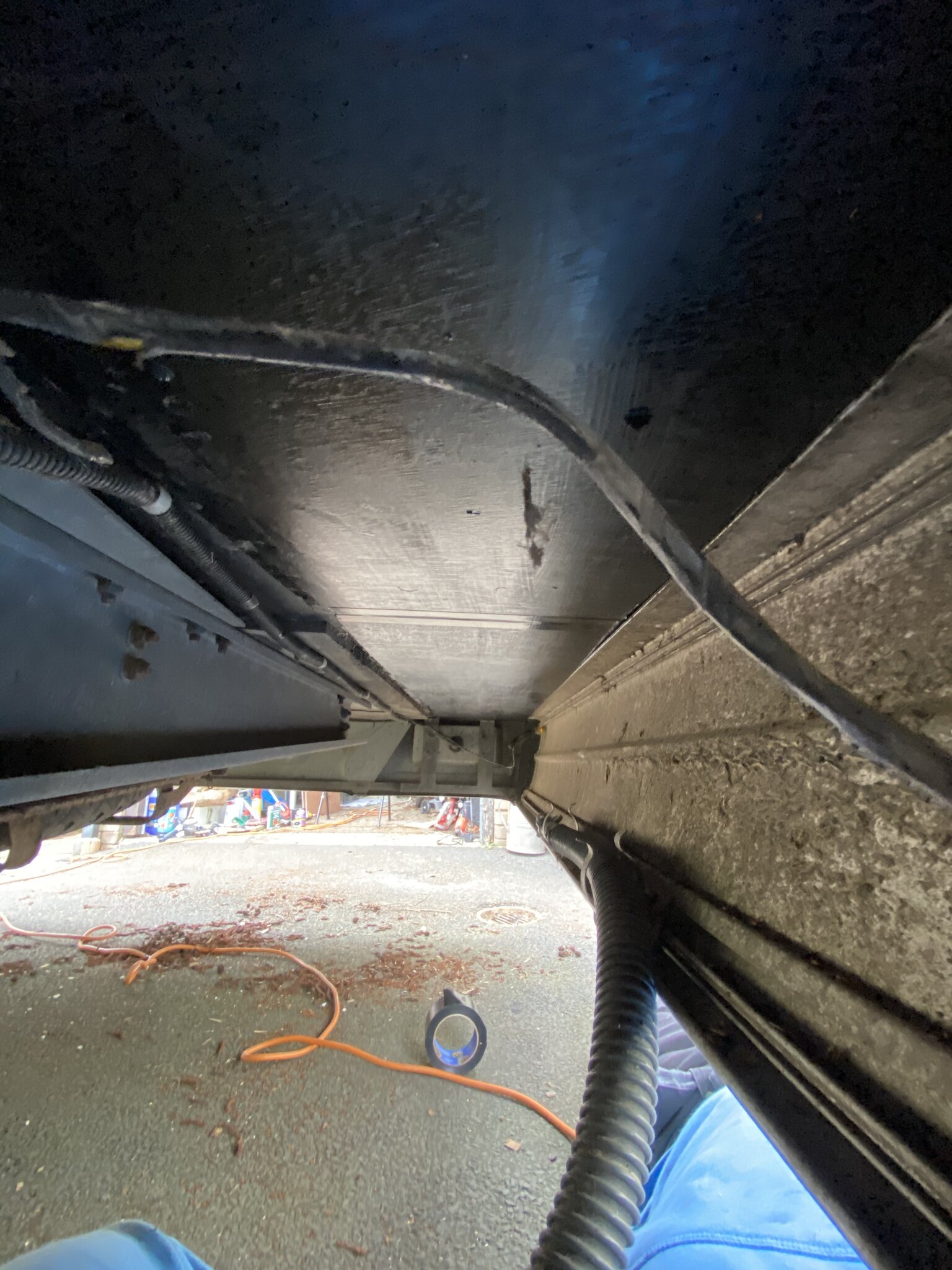

Nearing the end of the project now .
So far the total costs are £274 ( some of that is for tools I can use again and I purchased a bit too much of a few things ) and time taken is 25 hours . I would guess another full day and it should be pretty much completely finished .
I have been extremely lucky with the weather, no rain at all since I started the work on Wednesday.
I will certainly be a lot more aware of any problems in the future and shall be checking the motorhome on a regular basis 👍🏻👍🏻👍🏻

Basically I gave the motorhome the first wash of the year today and also a good walk round and check over . Spotted a nasty gap in the sealant between the body trim and the side wall under the cassette access hatch . I was aware of a problem with the trim allowing water to get behind it and cause the floor to get wet underneath the van .
I had just washed it so I had I look underneath and this is what it looked like .
I pressed the floor from underneath and sure enough it was spongy 🙁. I’ve had a good search on here and it appears it been a big problem with others in the past . I think I may have caught it early but the damage isn’t good .

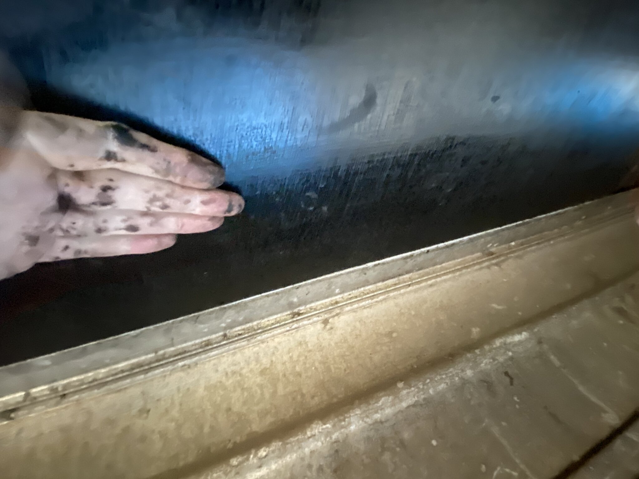

The problem is a black sheet of vinyl attached to the timber .Water runs down the van and behind the trim . The floor soaks in the water and the vinyl prevents the timber from ever drying out .
Checked the whole underside and there is a patch the other side under the step as well 🙈

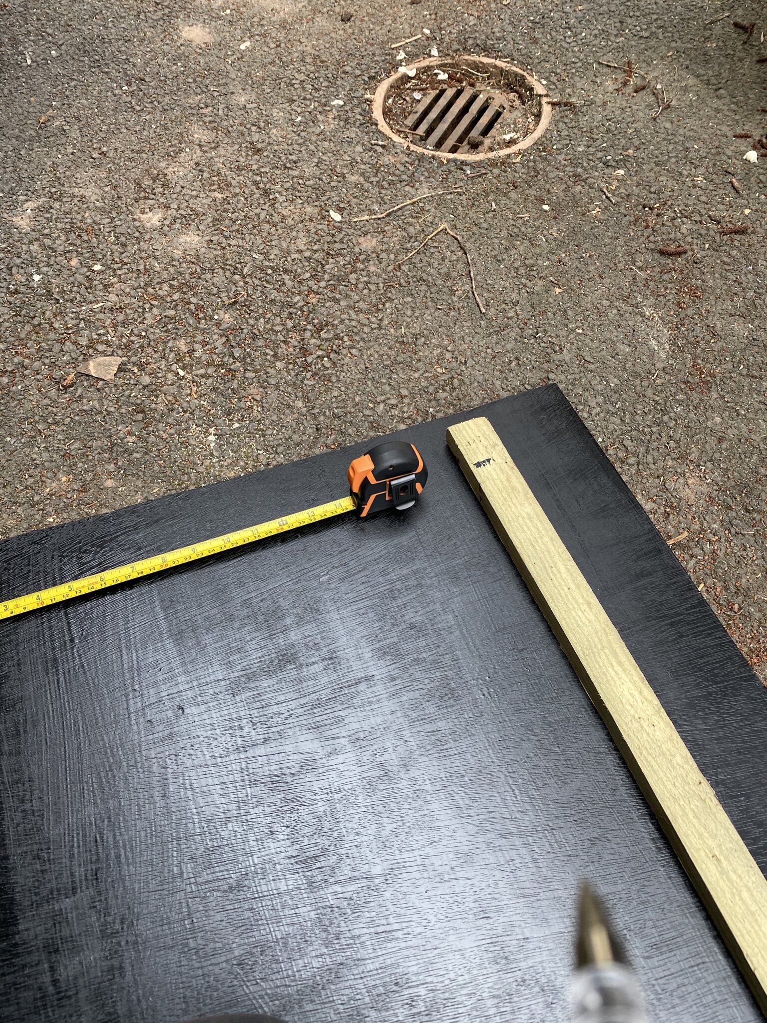

I’ve removed the offending vinyl to see the damage . It’s bad but the inside of the van is dry and it’s just the bottom layer of ply timber that’s wet . I hope to cut out the board and replace it . Not very good at this kind of thing but will give it a go .
pictures of the vinyl cover that traps the water and the damage .

Great job well done i have the same van had a look and mine looks good underneath i havent got the plastic sheet that cover's the wood underneath 2004 my year going to treat the underneath wood as its been done before,what did you treat yours with? cheers matt
It looks like he used Sandtex exterior paint, ( picture on about 12th post) I have used this on my old front door fantastic exterior paint.
Hi Matt , yes as PJGWiltshire said it was Sandtex exterior 10 year paint. I am glad you didn’t have the plastic sheeting as it was a complete disaster and should never have been used .
It looks just plain wood thats been protected before,do i rub it down or just paint over? Not to far from you swifter im no far from Tewkesbury.
I wouldn’t worry about it in your case . It’s the plastic cover that caused all the problems as the wood that was getting wet from the unsealed side trim was unable to ever dry out and was completely sealed in when damp . Thank god I found the problem when I did because it was never ever going to dry out . I am disappointed with myself for buying a motorhome that had these problems but I will also never make the same mistake again . If you think the underside of the motorhome needs a paint then just sand back a little and then paint it. It’s not a very quick process as you will be on your back with most of the paint trying fall off the brush so it takes a while . Luckily I was able to paint the replacement boards before fixing them in place . I only needed to paint a few of the underside areas directly so it wasn’t a long process .👍🏻👍🏻
