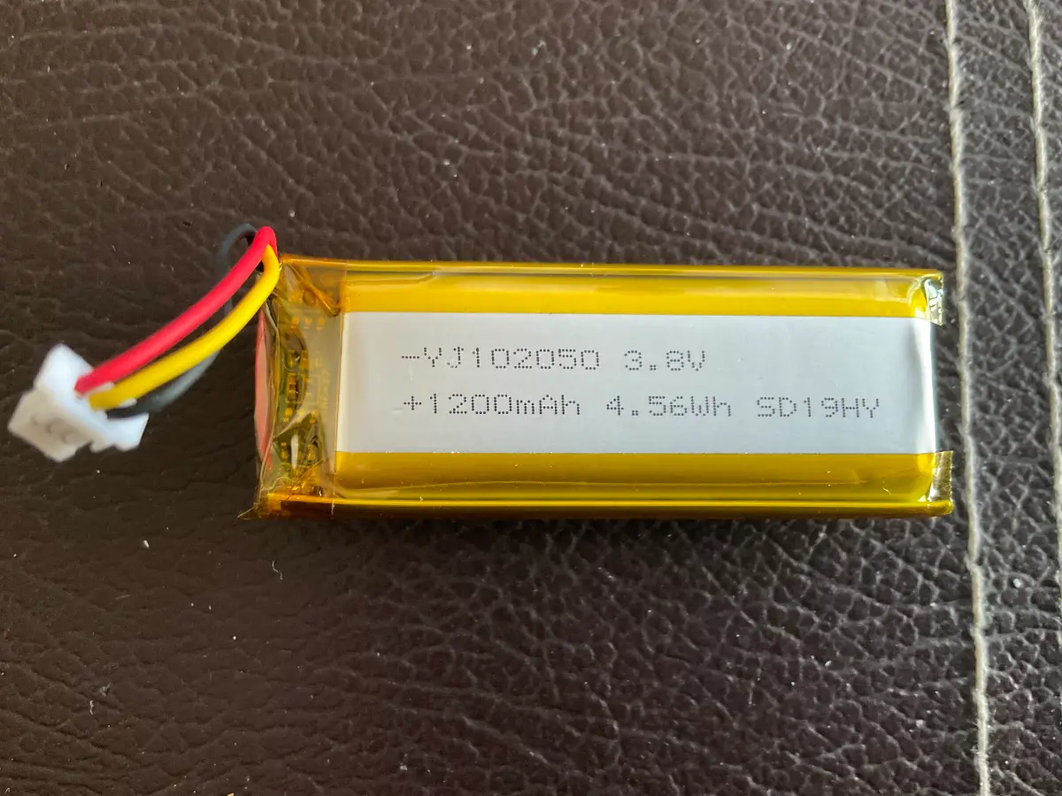

This is from my motorcycle helmet (Schuberth C5), it’s a Sena device but neither Schuberth or Sena appear to supply them from their websites, unless I’ve missed something.
EBay appears to have similar (3.7 and 1000mAh) though not with the three wires and plug.
Get same spec battery and snip off original battery connectors. I've had to do this with sons radio control cars.
EBay appears to have similar (3.7 and 1000mAh) though not with the three wires and plug.View attachment 1055951
https://www.ebay.co.uk/itm/12652752...pid=5339023013&customid=&toolid=10001&mkevt=1
The numbers on the smaller lithium ion batteries are the dimensions of the battery in millimetres. 👍
That’s the risk with the one I’ve ordered, all the specs are correct, 3.8v, 1200mAh but I couldn’t find the size in the add.
Though I’m fairly sure the Schuberth SC2 is based on Sena 50.
Not resolved yet, think I’ve ordered the wrong ones from Aliexpress. They didn’t show sizes but I found out elsewhere the Sena 50C has shorter squarer batteries and I think I need the 50R type, though the ones shown above in the Googlebot post show three wires but state two wires then say compatible with both which leaves me confused and in the position of waiting weeks for something to come that could be wrong.
