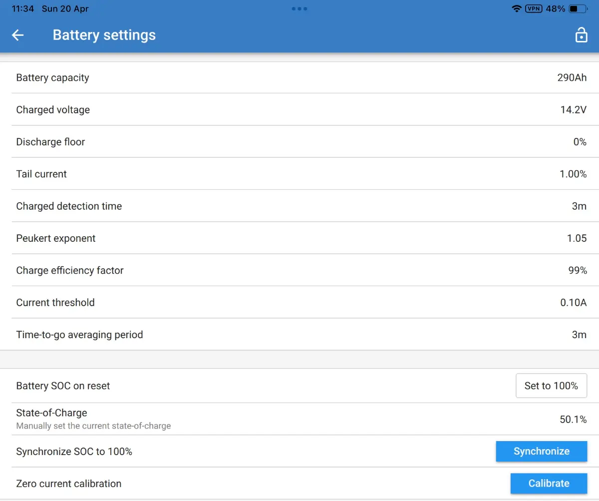

Can you post a photo of your shunt settings.
My intention was to let it run to around 12.25v then get EHU for a day to charge it fully.
Is your discharge floor not a bit low? Thought FS recommended 20%. Not that it will affect the battery turning off. Just jumped out at me.
That would be my lowest too, but, not under load voltage. The problem is, being at 12.25v and turn on a large load, it may trigger the bms.
Also your shunt settings look good to me, except one, I would change peukert value from 1.05 to 1.02.
