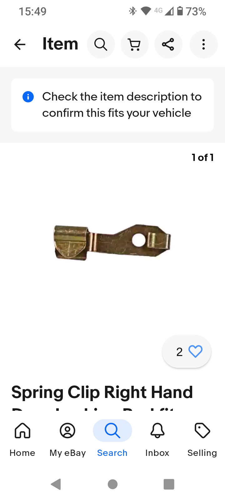

You need a clip similar to this.
Put the rod into position.
Put the hole over the open end of the rod.
Clip the left hand end over the rod.
These are so common on cars but I can't find a link anywhere.
