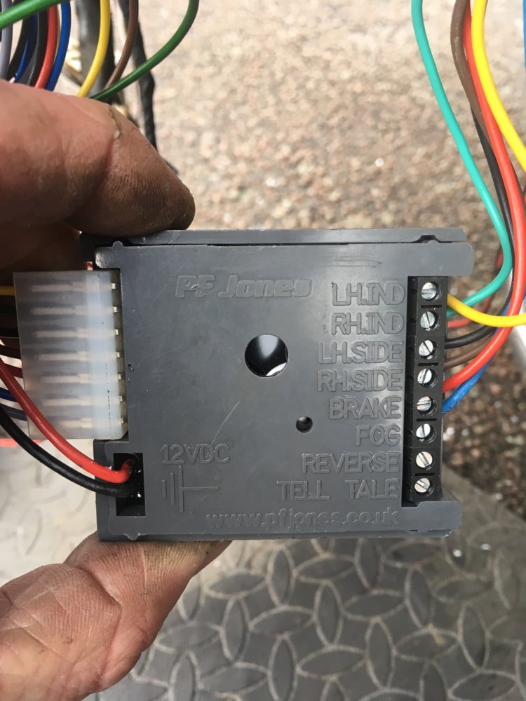

We had a whistling internittent noise that I finally traced to the interface unit for the towbar wiring. Had it replaced, whistle gone.
I'm still at a loss. It has now occurred whilst parked up, engine off, on hook-up, 12V control panel off etc. So, this interface unit you mention...is that something that is fitted only when you have a towbar, or is it something that is part of the base vehicle electronics. In other words, would I have one?
Cambus wiring kit for towbars ---
I had similar occasional beep that was eventually traced to the towbar canbus unit. You would only have one if you have a towbar though, or if someone has fitted electrics for one. I did just remove the power supply to it, before replacing the unit, not that I use the towbar though.
Our "noise" became apparent in the middle of the night on a Welsh hillside, that's when I eventually traced it to the towbar unit. As Lanyandy, I disconnected the power cable and it stopped and eventually had the towbar re-wired.
View attachment 289371 traced to the towbar canbus unit.
This actually started screeching as I washed back of motorhome and was rinsing with hosepipe. Found the unit located behind the rear light cluster. Moisture had gotten to the unit on this occasion but a dodgy connection could do likewise.
