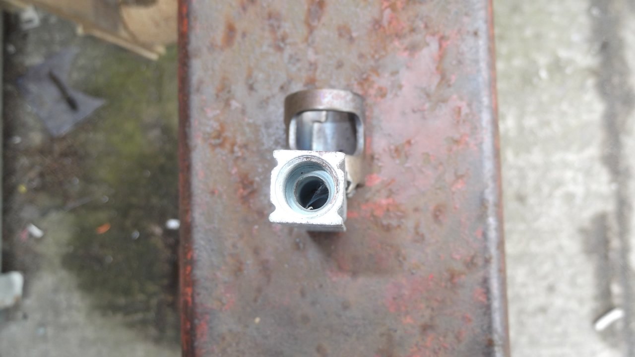

No need for a photo, being roof mounted tells me its a S3002 type heater. It probably needs cleaning out. Spiders like to build nests in the combustion air intakes and cause all sorts of problems. Only this week we had a motorhome in for hab inspection and the fridge would light on gas but after ten seconds or so was popping and spitting flame out of the air hole, turned out to be spiders web in the burner assembly as you can see in the photo.
D.
