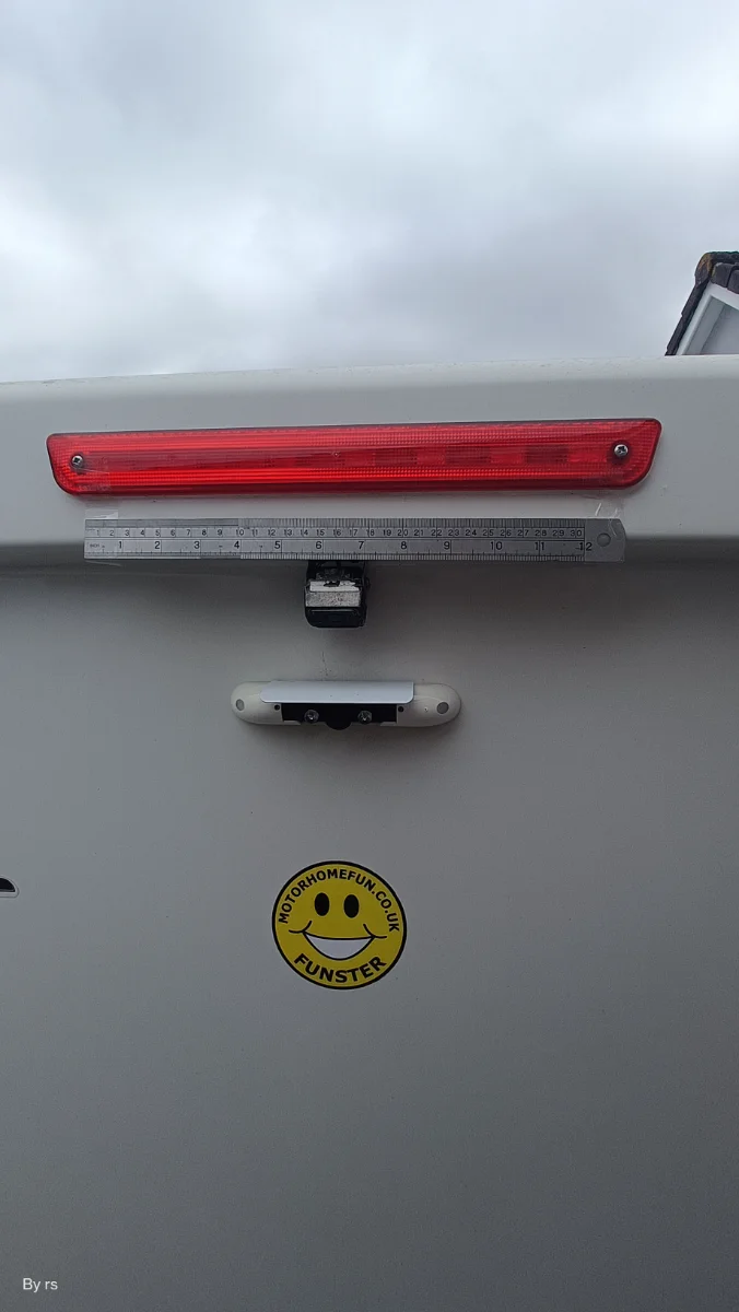

When my identical high level light got an advisory last year, I saw and found mine there and yours looks identical to our Pilote.
01823 665474
I'll post a photo of our's tomorrow. (Bit dark right now)
01823 665474
