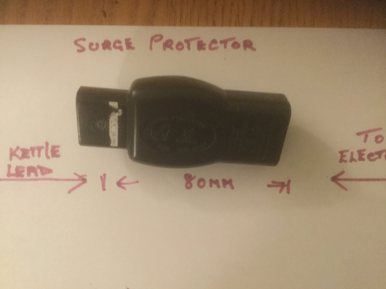

Has anybody got any advice on this please,was on lead before Electroblock as a surge protector,did not work.Can you still get them if so are they any good?Not sure what to fit,your advice would be much Appreciated.

We struggled to get a surge protector for a boiler that kept blowing PCB's and only found one that had to be fitted into an enclosure which made it very large and expensive, it did do the job and we never had another problem with it.
you could fit one to your mains consumer unit if there is space or is
this any good to you
That's an RCD Phill, not a surge protector.
The EBL needs protecting from under voltage and over voltage, not just Spikes. Also check the speed that the device cuts the power as some cheapo ones are slower.
I fitted an AVS30 it protects against under & over voltages and surges. I originally fitted one on my last van when we were going to do a long ferry crossing as ships generators are notorious for there crap output.

Thanks to you all for your valued advice,i think i will purchase a Sollatek AVS 30,seems the best for the job.Many thanks.
Think theybare about £70
Just checked gone up a bit £79.80 from RS now, when I bought mine I think they were £64 but I had a 20% off voucher so only cost me £51.
At the moment £62 on Amazon or you can get them from China on eBay for £46, not sure I would risk a safety critical item from China on eBay as could be a cheap copy.
Personally I would only go for a branded product like the Sollatek AVS or Schaudt OVP
A component like this is something that you rely on so saving a few quid by buying a hand knitted in china plastic box is not for me!

The Schudt OVP just plugs into the EBL to protect it. The AVS30 protects your whole system, that's the reason I fitted it.
