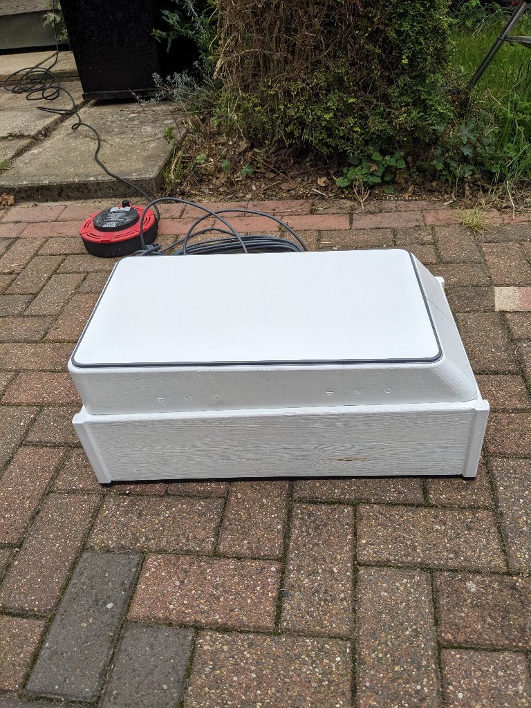

I’ve purchased a compact almost purpose designed electrical box to store the 75ft cable in on the roof when travelling. This will enable me to move the dish from the roof to the ground should I have obstacles obstructing the dish, but very easily without too much faff.
