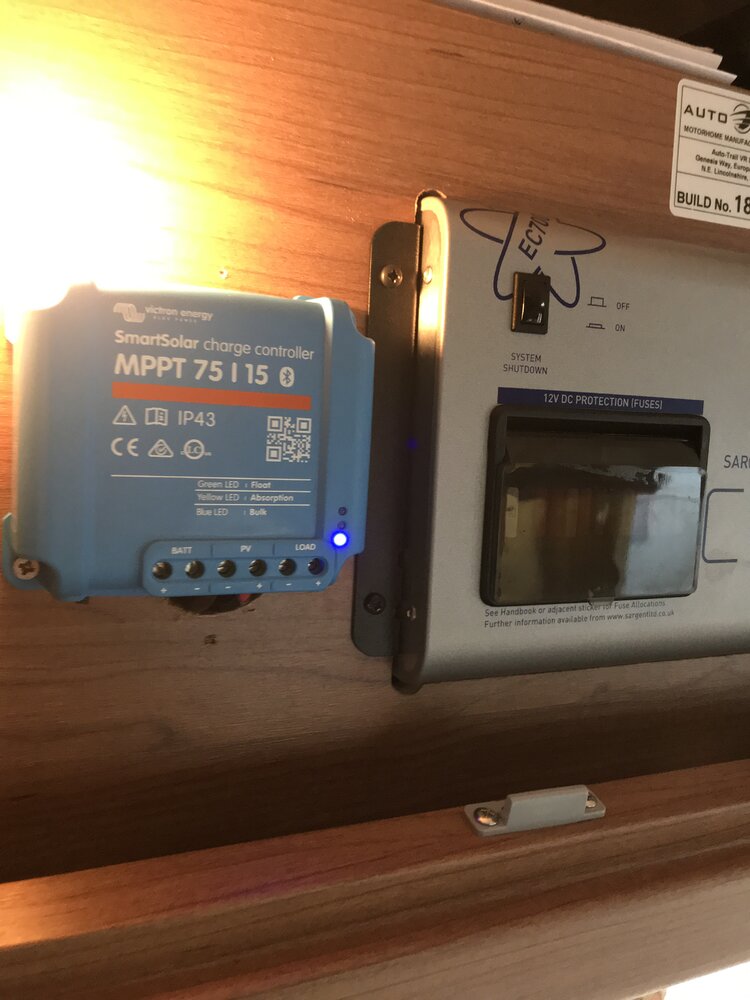

this is my install completed yesterday
I ordered the end deflector/mounts longer than needed at 68cm and cut down to 515cm needed to span the panels width. I then used the offcuts down the panels length for A. more fixing area and B. as it’s a long panels gave it better rigidity.
Victron Smart Solar MPPT controller completes the install and no connection to the Sargent unit so keep this and the original solar installation completely separate
