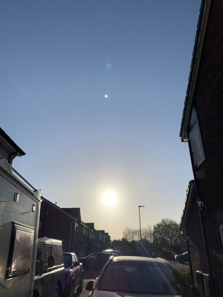

Good morning all, it is a nice sunny morning in Warrington, just took some readings of the battery's 2 x110amp both showing 12.8 v and the same reading on the controller. some readings from the panel. forgot to mention the readings yesterday where at 15.00 it went overcast about 19.00 the readings this morning 7.35

Just seen you are in Warrington, I'm on the south coat I don't believe the 7.1 amps is accurate, 4-5 amps more realistic.
Something not right there unless the regulator you have bought is not a multistage charger.
Decent multistage regulators will charge the battery to 14.2 v then hold that voltage for the absorption phase (time set by type of battery) then drop to a float of 13.8v.
12.8 indicates no float charge.
Edit:
I just realised you only just took those readings before 8 am so what I just said could be a load of bol**ks.
The batteries will have settled overnight and when the sun came up the charging cycle will have started again. If there is no load on the batteries being fully charged last night with the sun being up for over 2 hours I would have expected the voltage to be ramping up towards 14v by now.
A sun that low in Warrington will probably only be managing 10 watts so half an amp looks about right
