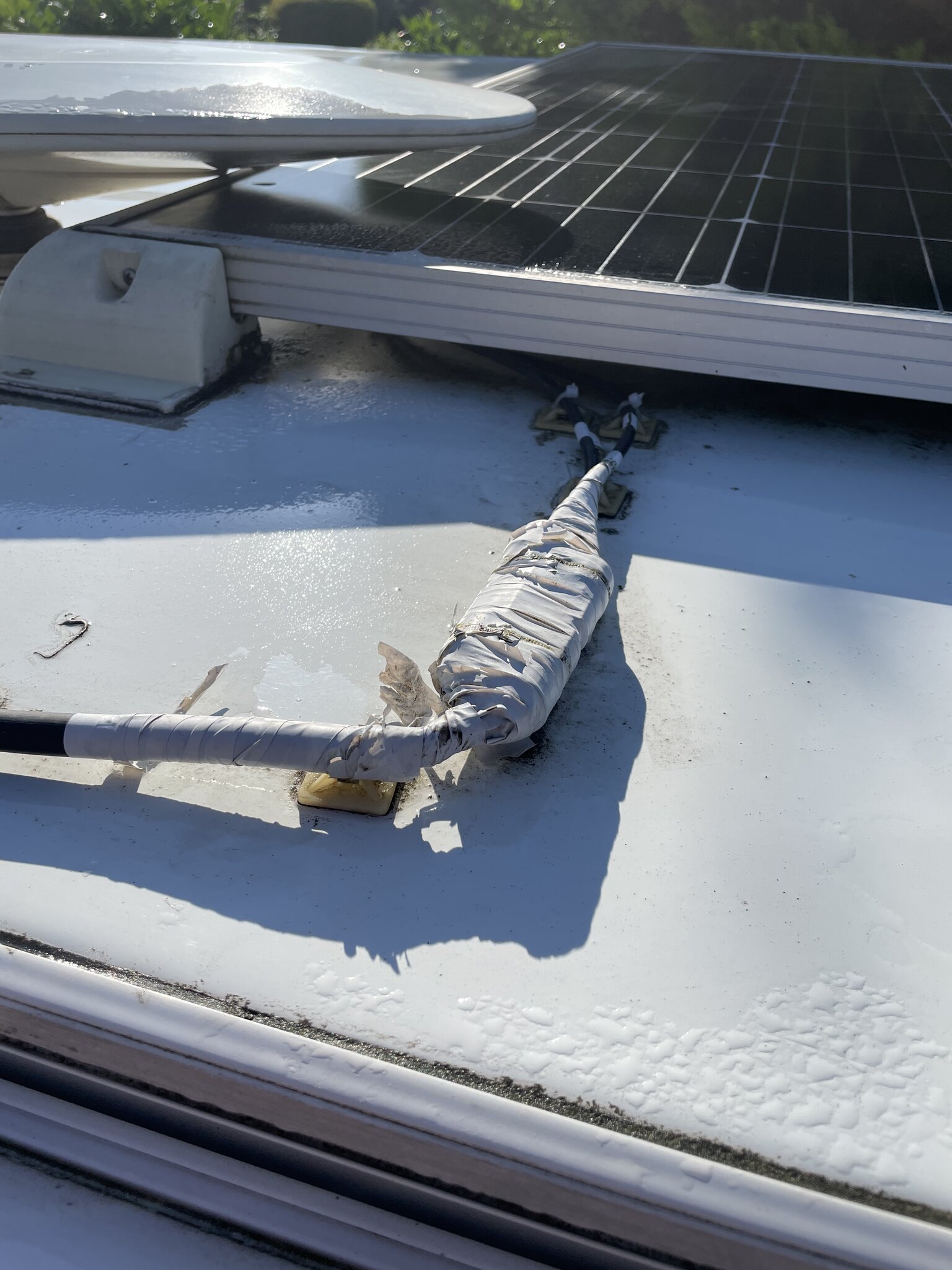

There were connectors and you were correct to check there - looks like one of the inners was/has been replaced with a bullet type connector which wasn’t in correctly a little pull and the cable came out… I will order more and bill the dealer

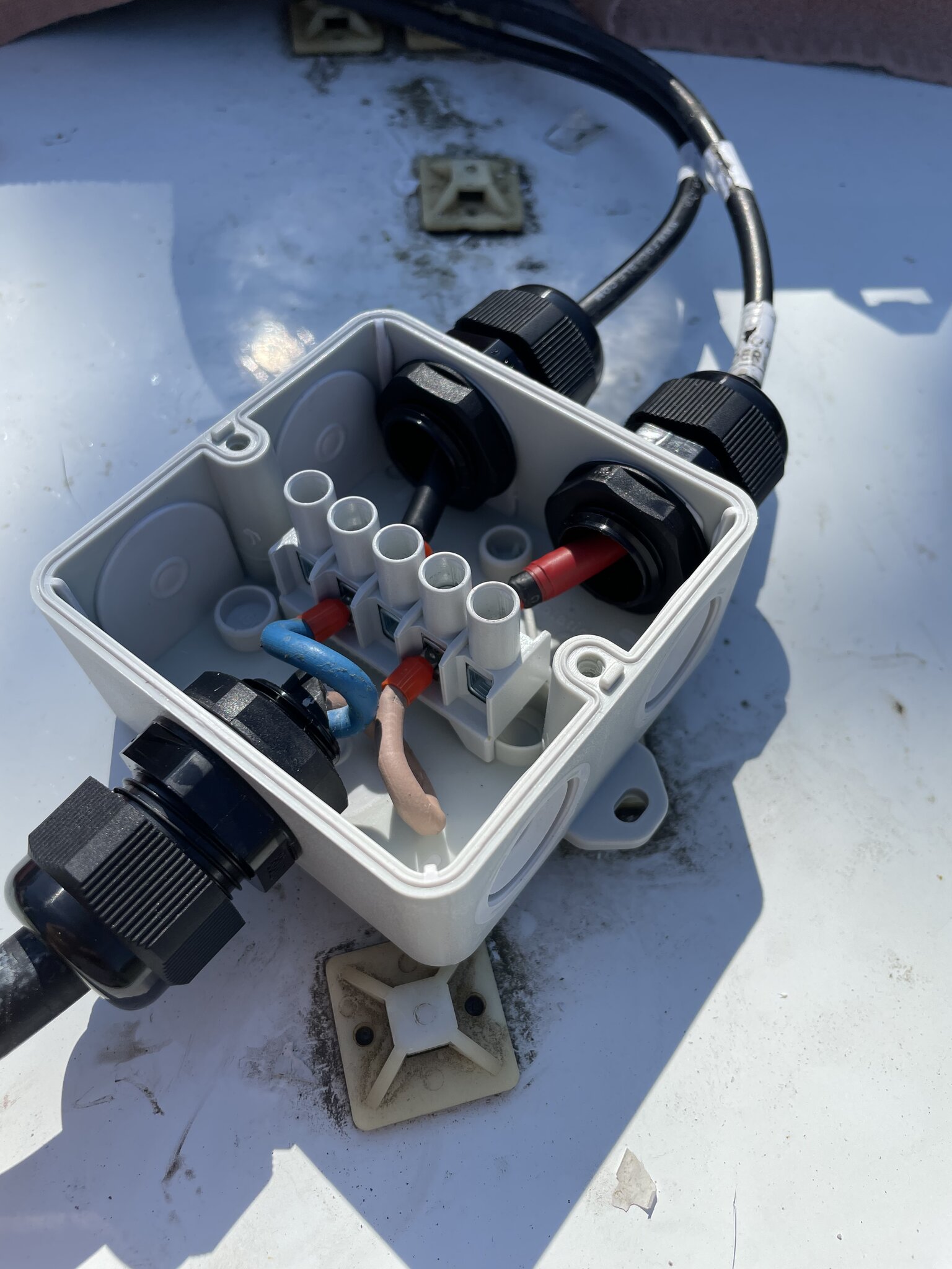

Thanks - I’ve order a kit but in the meantime effected a repair. I’ll keep an eye on the box and if it stays dry I think I am going to leave it - the connectors are single core and the cable going into the can is multi core so I would always have to re-seal the connectors with tape. The way I’ve done it should be a more weather tight solution…
