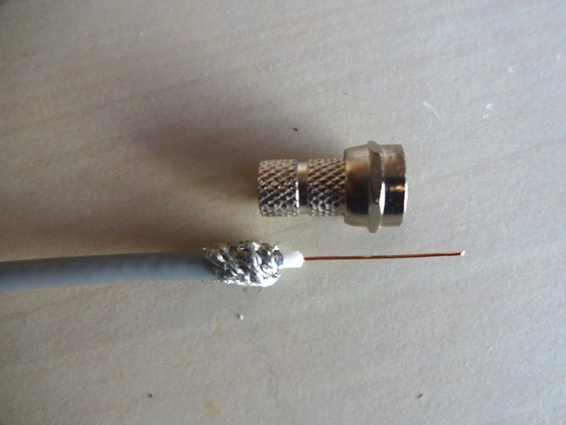

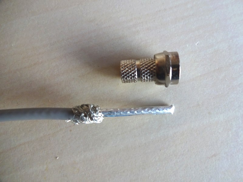

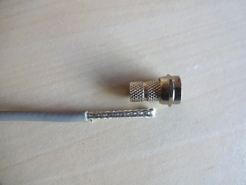

Right, the method I have used is to cut the coax to the required length for your installation , slip on 2 length of heatshrink that will fit over the knurled section of the plug and that's about 2 to 3 times longer the the knurled section of the F plug.
Cut back the outer cover to twice the length of the F plug knurled section.
Fold the next layer, the mesh like strands back and over the outer cover coax cover to form a sort of ball about 5 or 6mm long,
now cut off the silver foil back to the mesh ball and discard.
Carefully cut back the white insulator without cutting into the copper core to about 2 to 3mm from the mesh ball,
The inner part of the F plug is threaded, so screw the F plug onto the mesh ball until the white insulator protrudes about 2mm clear of the F plug
inner face enough that the copper wire centre of the coax can not touch the sides of the hole it comes through and short out.
Now cut the copper wire centre of the coax to protrude past the end of the F plug about 3mm
If you have done this right then the F plug should be pretty secure on the cable,
but just to be sure shrink on the 2 layers of heatshrink to make sure everything stays in place.

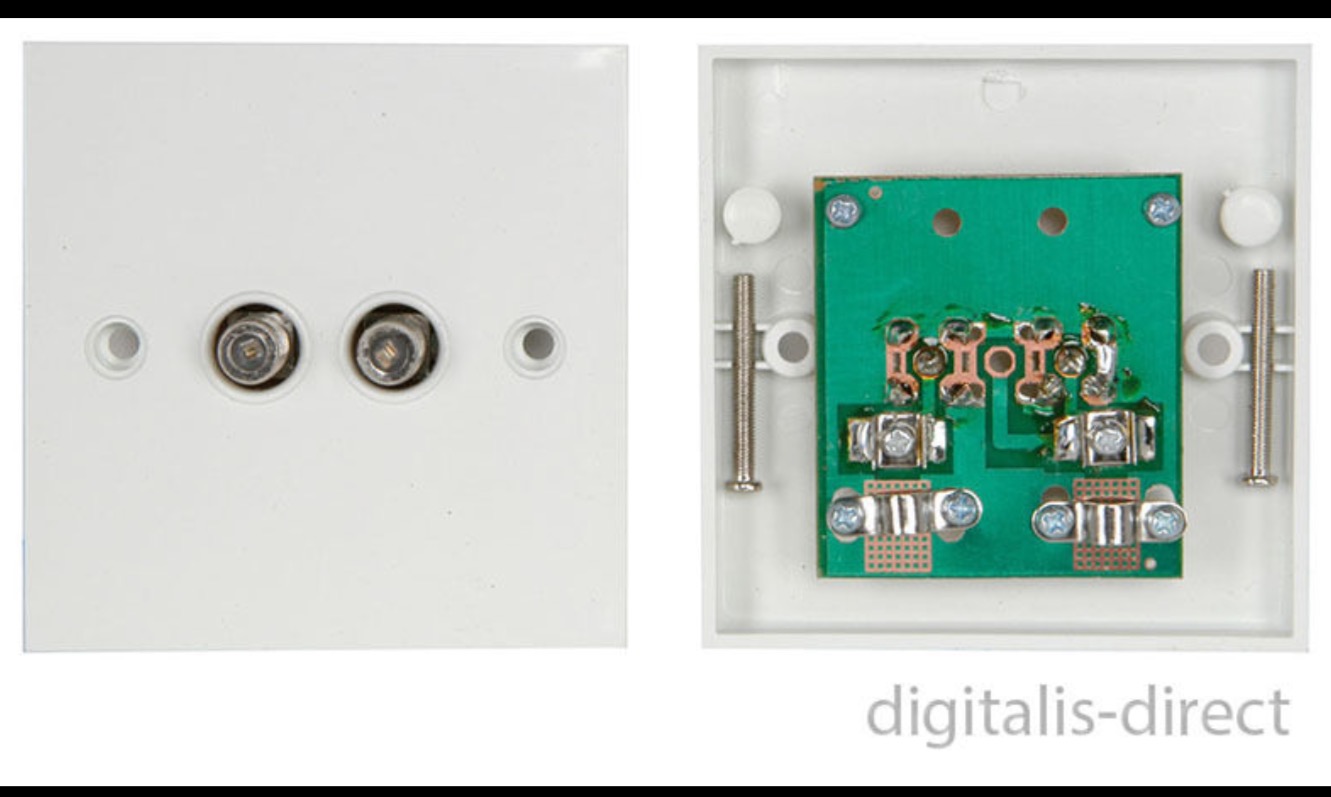

Alternatively, the OP could terminate the snipe cable to a twin wall type faceplate like this one, then just use short cables to the receiver
