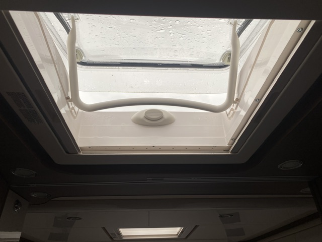

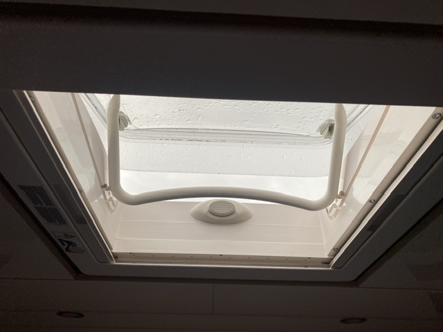

I have noticed that the skylight in the bedroom doesn’t have a seal ( pictures showing one with/without), is this normal to allow ventilation or missing?, as all the other skylights have one fitted. Due to the high winds recently it was quite noticeable, whistling on occasions- so any reason why I can’t fit one? - and last question any ideas where I would get one from.

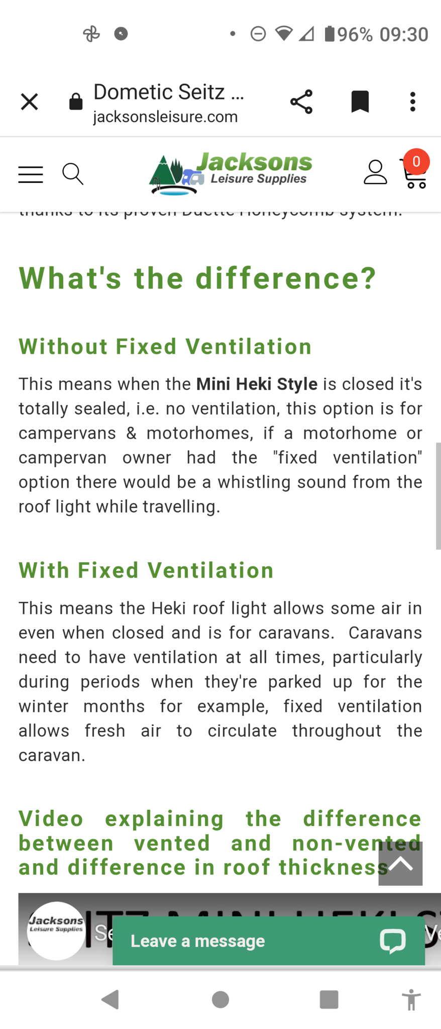

That is the Mini Heki ,,.
they come with or without 'forced ventilation ' .. forced ventilation model is fitted in the bedroom as a safety feature ..
It's not supposed to have it's part of the required permanent ventilation in a motorhome.
Okay thanks both, I thought that might be the case. I will have to see how bad the whistles get then. I suppose better to leave it as factory fitted and not seal.

You can buy a seal for the mini Heki if your happy with the ventilation elsewhere. Easily fitted if you remove the lens. Makes a huge difference to cold draughts in winter.

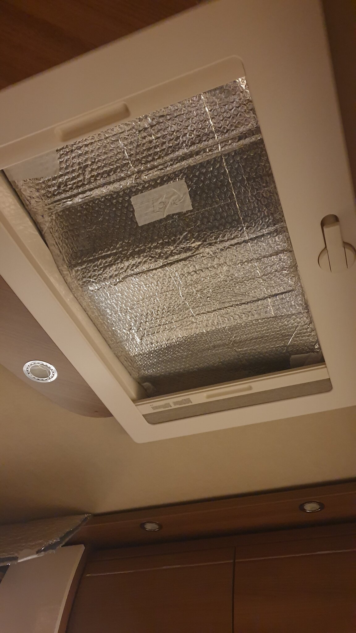

I cut some aluminium foil insulation down to size for all of our roof lights and it makes huge difference in Winter. Bedroom rooflight still flaps in the breeze but no draught now.
I agree, I have pads for our skylights too, I also use them in sunny weather during the day and peg them to the open roof light to keep the sun out.
