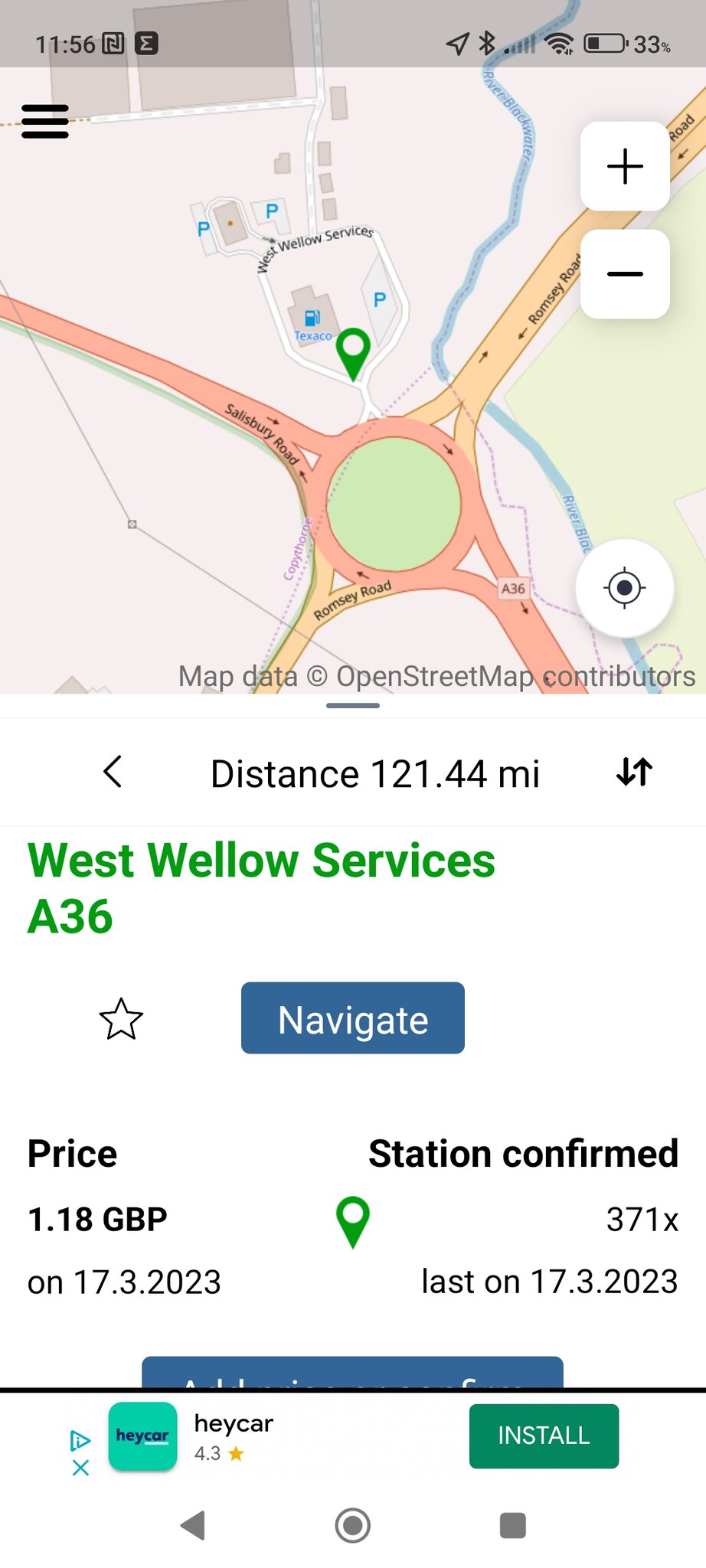

Download 'myLPG.eu.' Its tell where they all are in the all of Europe -- and current prices
I use 2 X 10kg safefill. Lucky for me I have several places within a few miles 👍 as mentioned you don't need a fill point as the fill connection goes straight onto the bottle.
There are several apps like mylpg.eu and others. Download and check locations in your area, the safefill list is never up to date. I have seen a few taxi companies who now have their own tanks and allow public to fill.
Screenshot_2023-03-17-11-56-55-691_eu.mylpg.android.jpg Screenshot_2023-03-17-11-56-21-891_eu.mylpg.android.jpg Screenshot_2023-03-17-11-55-50-441_eu.mylpg.android.jpg
