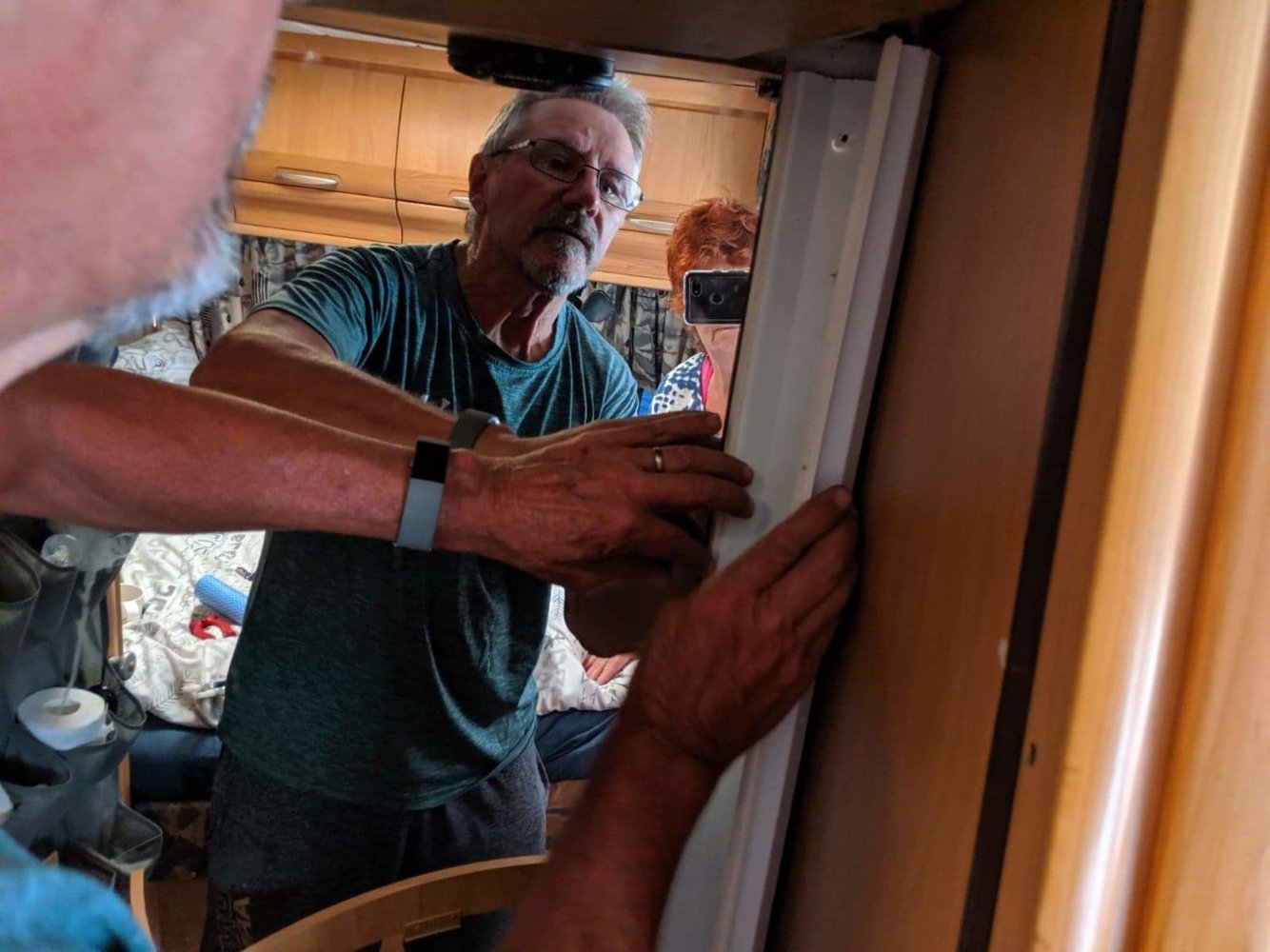

Right hand mirror slides away from one-self and is partly held in.position by the vertical light fitting.
