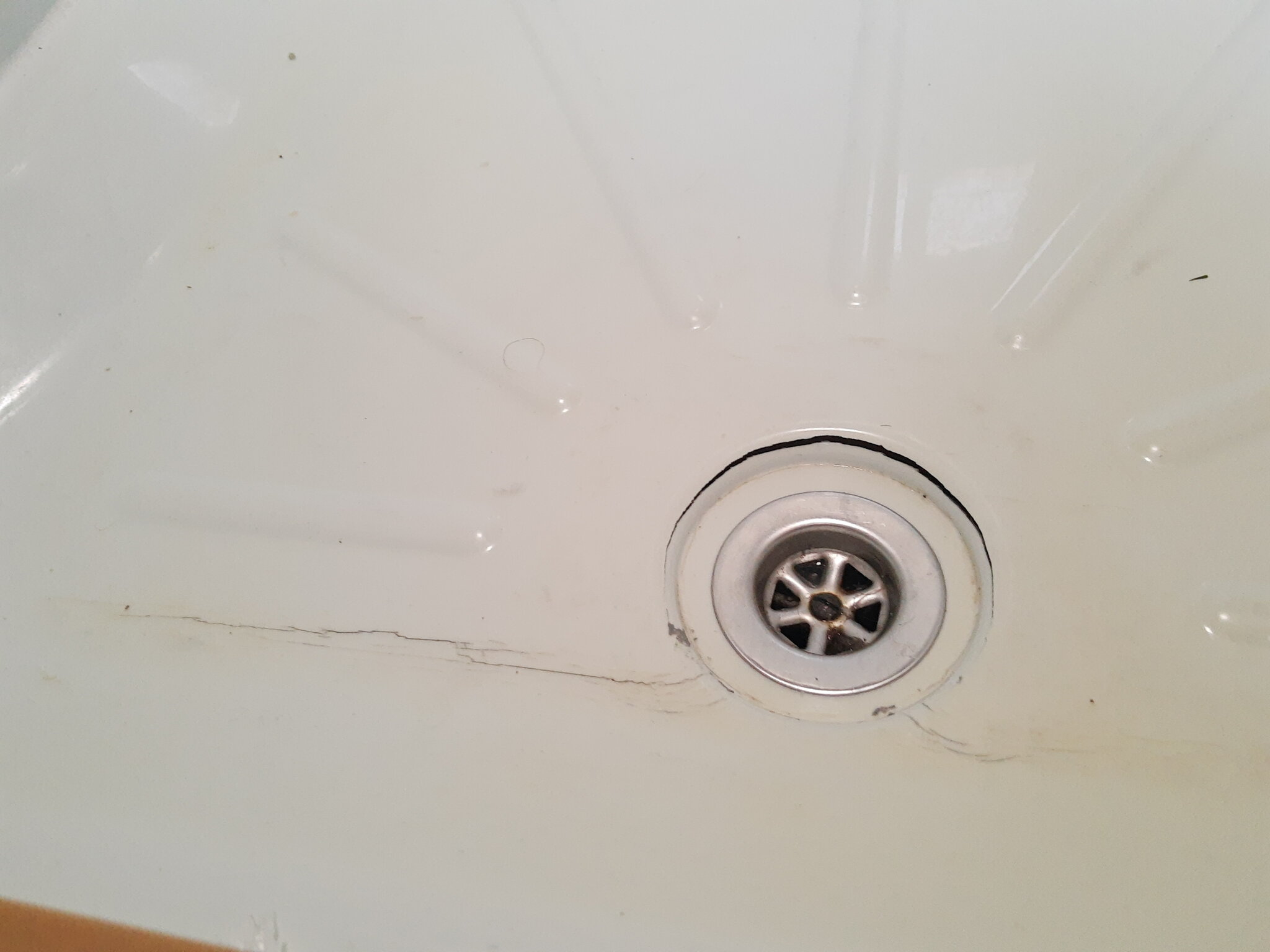

Our shower tray cracked during our latest trip. There had been a small hairline crack in the glaze for a while
It looks like a major job to replace, involving a lot of labour to remove the sink unit and shower surround.
Does anyone have any experience of having a shower tray replaced, and how did it compare to the £450 quote I've had to have it repaired by Speedcoat, with a 10 year warranty?

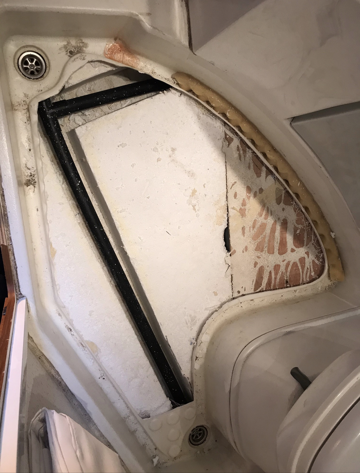

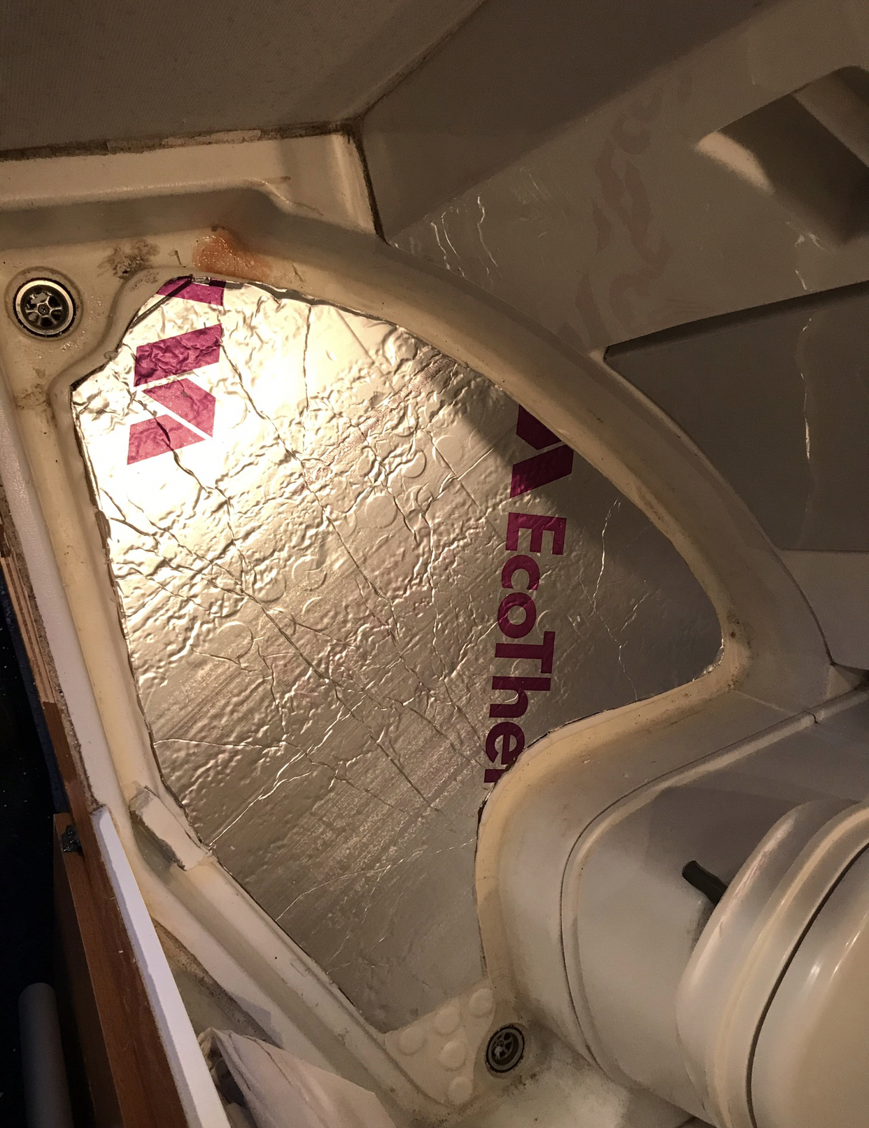

From the looks of the straight line crack running across your shower tray I would suspect it is not adequately supported underneath . This happened to mine . I carefully chain drilled around shower tray and removed the top then replaced the compacted foam sheet with a denser similar material from building suppliers . I then overlaid it with a thin piece of ply and sealed the removed section of tray back down with Hippo pro 3 sealant ( excellent sealant ) . Then made up wooden duckboard with 2 inch wide spreaders .
A few photos of my repair 5 years ago . I was shocked how poorly it was supported with low density polystyrene packing . This was Benimar . I replaced it with building grade high density polystyrene insulation covered over with ply sheet .below is link to sealant used .

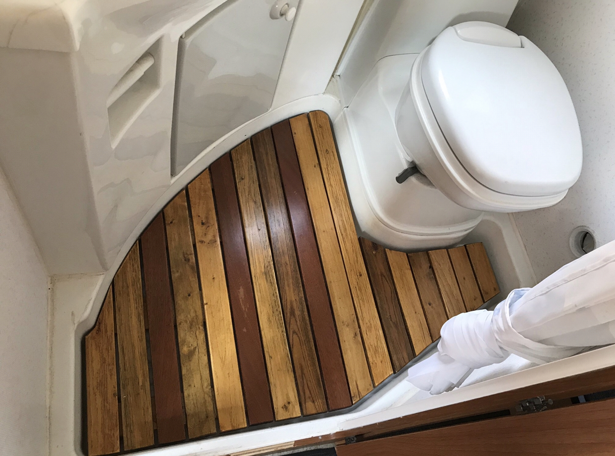

The duckboard is made from a reclaimed garden bench seat with hard wood slats . Sanded down and applied 3 coats yacht varnish
Made template for area first from hardboard and then cut spreaders to size and placed finished slats on top .
5BC21759-82DD-432F-B6EF-08FC8AA4F328.jpeg C89A2A7B-A5F4-45CF-9370-F9EBFF6513CA.jpeg
It is easily lifted out for cleaning of shower tray and drain area

I tried the expanding foam idea but didn’t work for me so I very carefully cut the top off using a Stanley knife and replaced the low density polystyrene rubbish support material used by Benimar that over time became compressed !

Correction I didn’t chain drill it off . I used a Stanley knife and very slowly and carefully cut it off . Not easy but taking time possible
