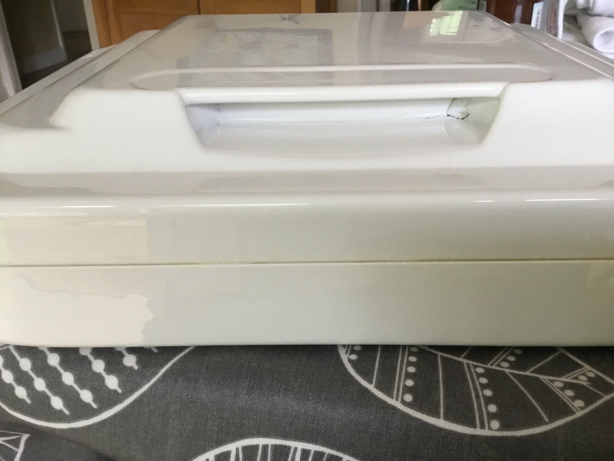

So the tiny crack in the drop-down sink, recessed hand hold, has nearly given way thanks to my cleaning efforts today.
Ideas wanted for a fix before the little bit on the end finally falls through into the body of the sink. There are cracks both ends and a small one all along. Don’t know why it has cracked, as there is no stress on it.

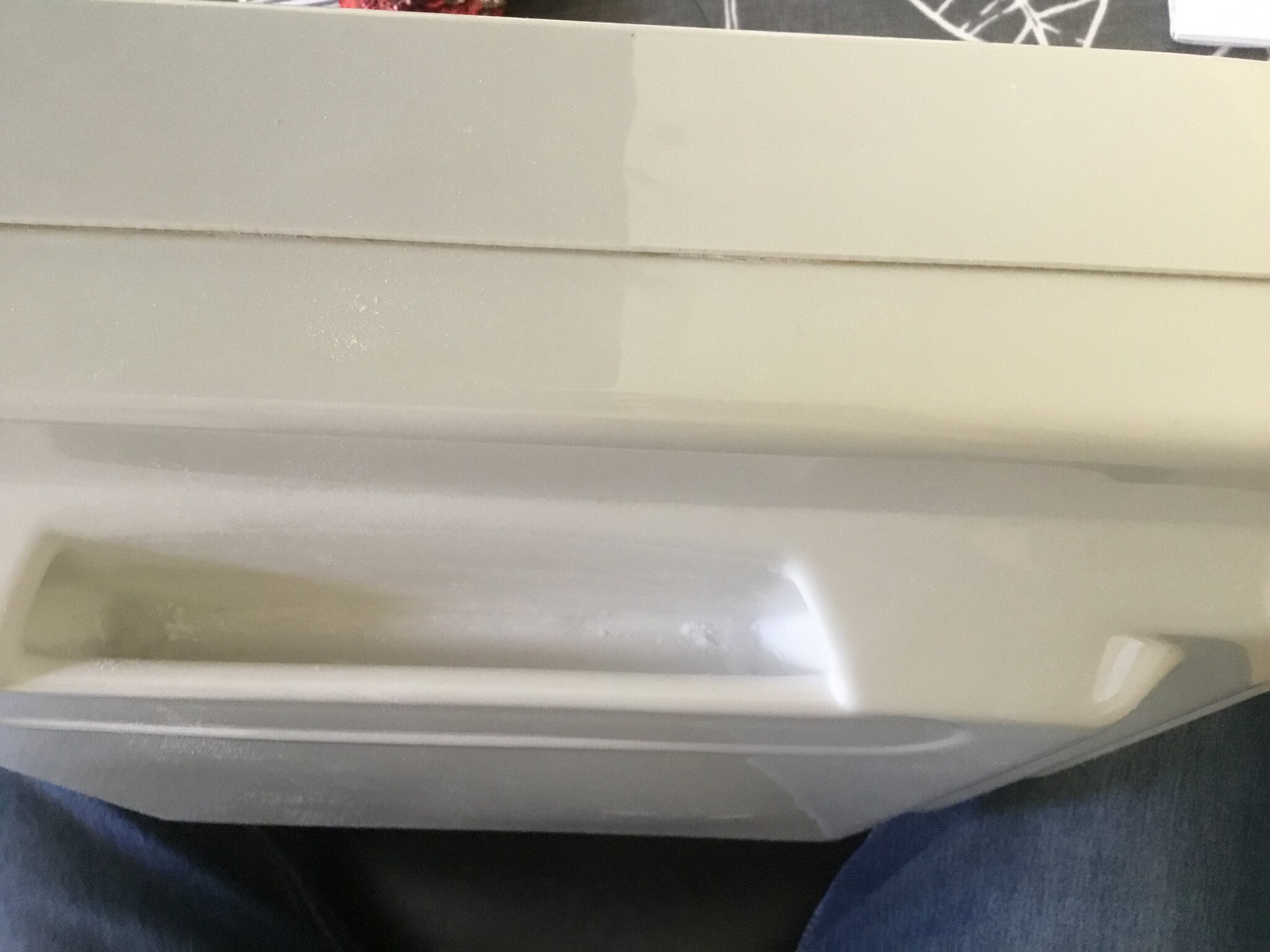

I successfully filled and strengthened the crackvand hole with superglue and bicarbonate of soda. I then found that I could not easily smooth down the hard craggy finish and I could not get a finger in with sandpaper without damaging the top edges. A small electric grinding tool also no good as couldn’t get a good angle. So I went with filling on top with crafting resin coloured gold, many thanks to Quackers Helen.
Now for the crack on the back behind the sink and the hairline one in the showertray!
Before
After filling, the loose bicarb brushed off, but had a rough finish that would be difficult to keep clean
