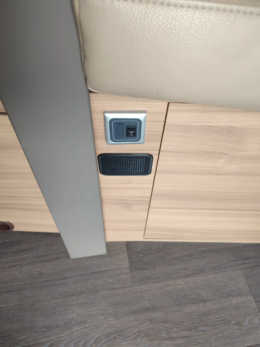

ive recently done away with the renogy remote switch, its ugly and far too big! i have just installed a switch with an led that lights up when the inverter is on that matches the existing switches and sockets. Of course that means that the 'fault' led is missing, but to be honest, you can tell by the screech of the inverter if you have overloaded it!!!
it was a simple install, but you do need to cut the old switch off and just use the existing cable ....
The on off switch is the furthest on the left
I 3D printed a cover for the hole where I removed the Renogy switch. It's got a grill so it looks like a vent if some sort
The only off switch is the furthest on the left

Although I went for a switch that matches the originals, a simple illuminated rocker switch also works, I tried it first and couldn't decide which switch to use, so went with the matching one.
I put it in a position where we have the kettle or cook with the induction hob or pizza maker. So it's in a readily accessible and convenient location.
Yeah it's smart.
