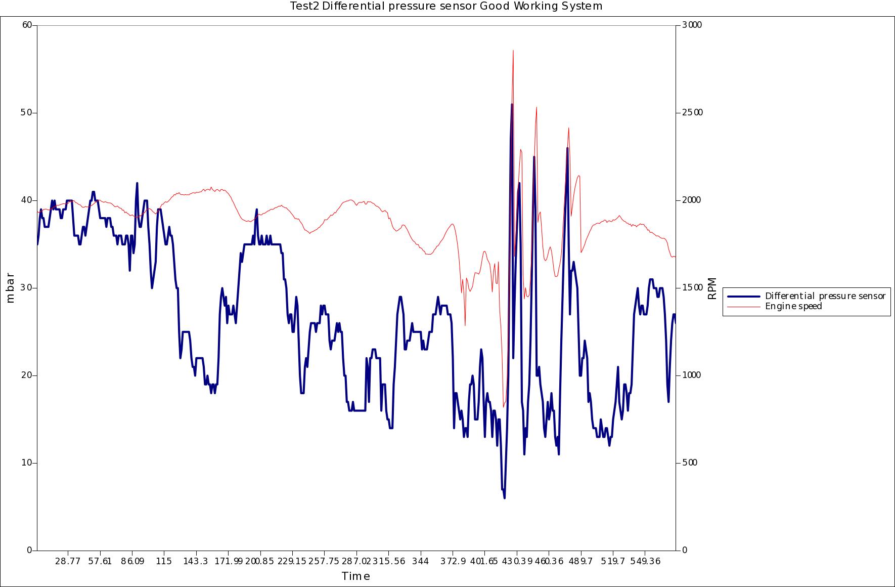

The OBD2 port allows interogation of the half dozen or so computers littered around a modern Ducato to deal with the 10s of sensors again littered around that are used to deal with all the environmental BS. You have 2 choices either be prepared to pay £7-10k for Fiat pro to change parts apparently willy nilly or DO it your self with a PC and Software like Multiecuscan.
A simple sensor fault can lead to a blocked DPF and lots of Money or understand whats going on.
The first graph is a sample of a good motor. The second is one on the way to a blocked dpf that was regenerating every 70 miles as opposed to a more normal 300. And no error codes to tell you what to do. A simple£30 sensor not changed intime caused this grief.

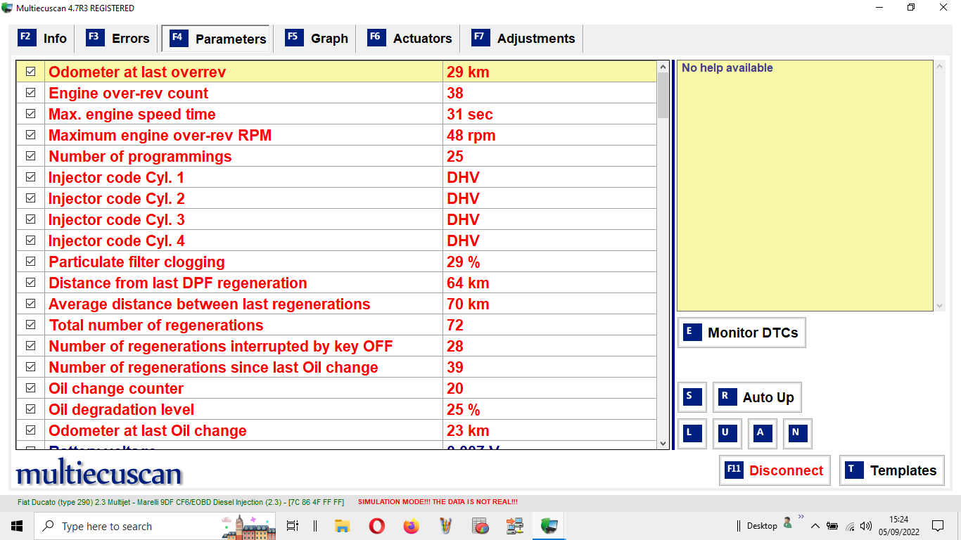

Multiecuscan does not specifically tell you if a sensor is working or not. it is bit like reading a book the story is on the pages the obd2 code is chapter title. Here is an example of how to determine a dpf differential Sensor problem. The second is how to save live data as a csv file to be analysed later.
Using the examples in the guide Take it for a run at least 10 minutes after warm (include coolant temperature in pid used) then post the csv file here or pm me.
This next template is for the dpf Regeneration process. And is mostly static info and a screenshot would do. This info is from a simulation not real data. M
