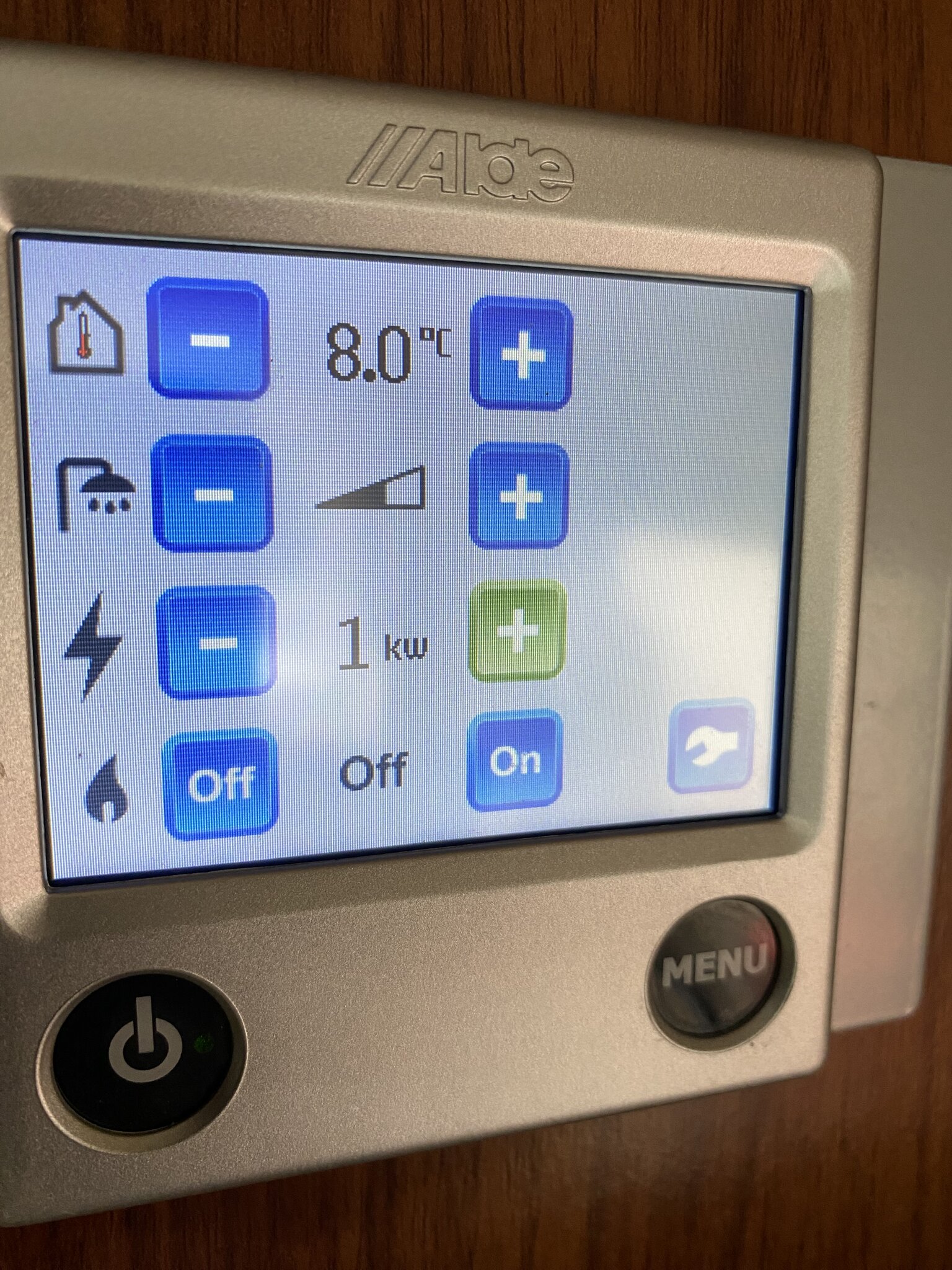

Oh Please!! ALdi heater not firing up. My first night HELP!
Nope on the 3020 you can have no cheese, half cheese and a full piece of cheese.
You can turn off the heat to the tap water by having the empty (no) cheese.
Normal heating of the water is by having half the cheese.
And a full cheese is a boost for when you go in shower or want a rapid warm up of water from cold, which in turn cuts the heating to the radiators👍
Been out to check ours, we only have two settings for our water, first photo is normal and I believe the second gives the water priority
Sadly no ‘off’
View attachment 836907View attachment 836906
It would be nice if the - button gave option to leave triangle empty
Surprised at this. If you press the minus button does the water triangular symbol not go white, which is off?
No, lowest is half full, + fills it - only goes back to half 🤔🙁
I am she back at Alde for fluid change early next year will check with them then but think 3010 doesn’t allow it
