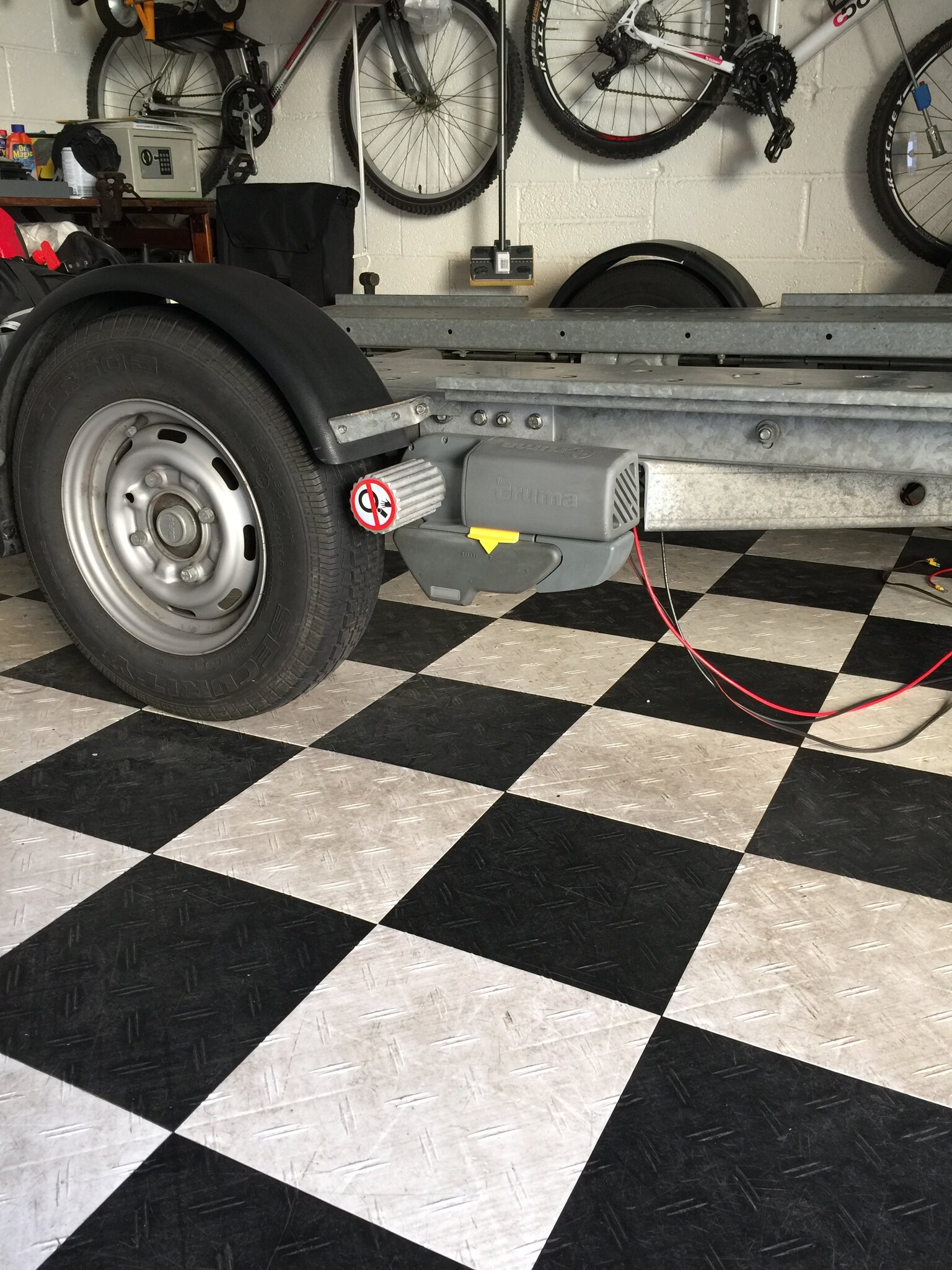

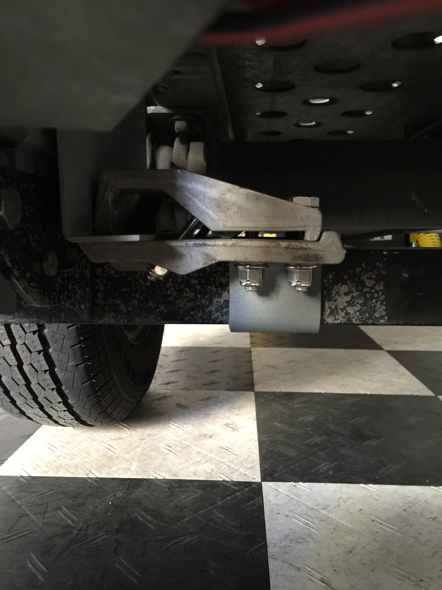

I fitted one to my smart car trailer a few years ago, I couldn’t find any motor mover fitting company willing to do it as it was more involved than fitting to a caravan as it’s simply a matter of bolting it to the caravan chassis.
I had to fabricate brackets which then bolted to the trailer frame and then fit all the electrics etc. Was worth it in the end so I could simply unhitch the trailer with the car still strapped on it and motor move it out of the way till I was ready to get it off, then I got fed up with having a trailer so bought the present motorhome which I can simply winch the smart car into the back 😂👍
Here are a few pics:
