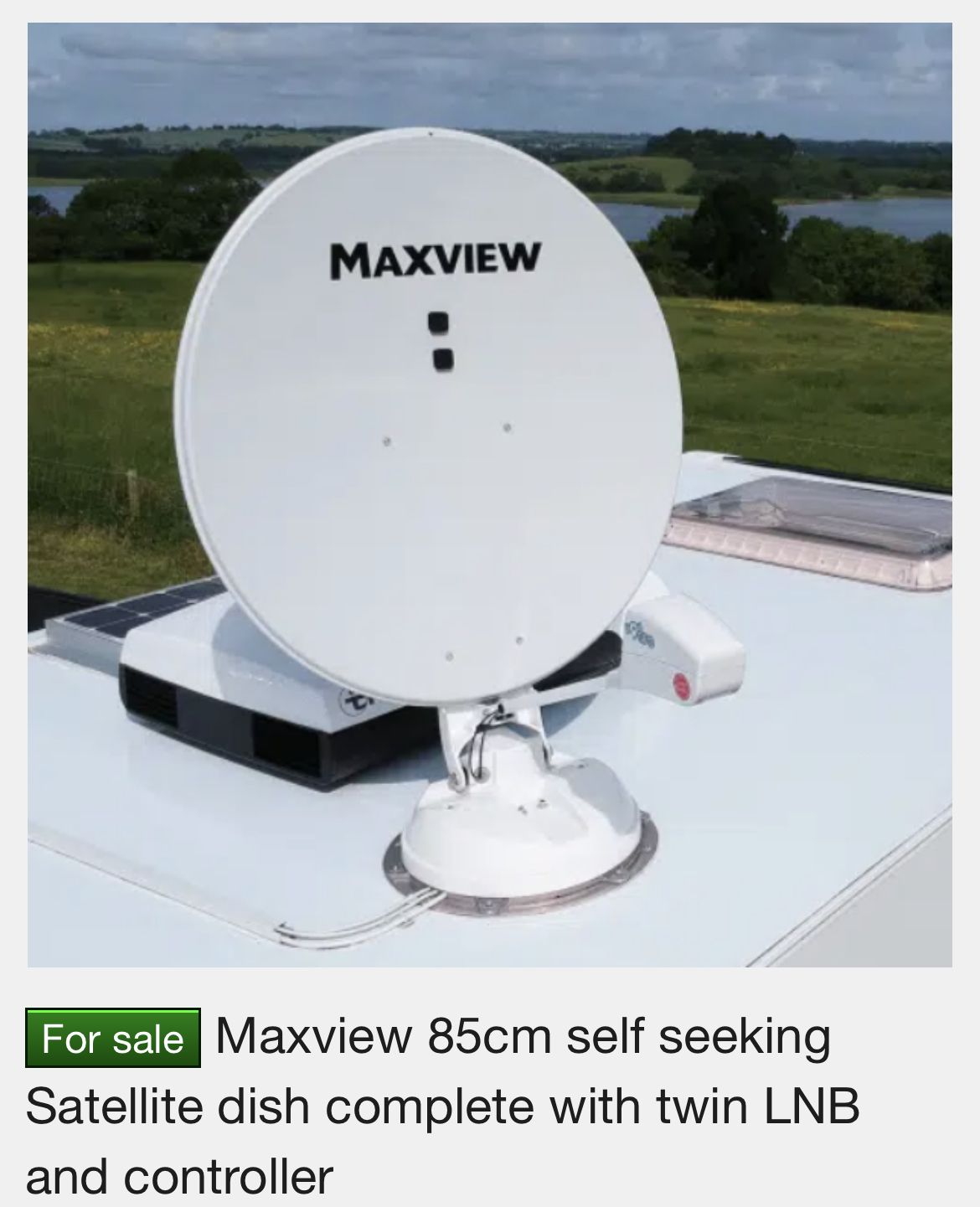

The dish is this one, same as I had on my Comanche, the LNB housing is a different design but I think the motor and control box/wiring is the same.
