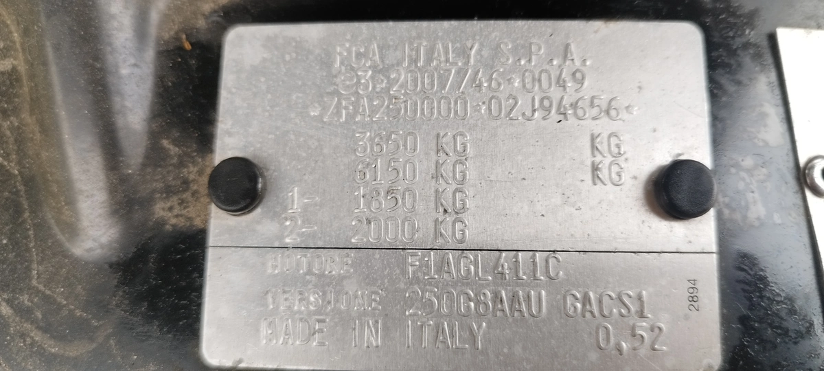

Took the 282 to a weighbridge yesterday. :oops:
Filled the fuel and water tank. Haven't put gear or clothes etc in yet and I was 3480 without driver. We have the 3650 so it looks like it will be just me and the dog as there is no weight for SHMBO SHCT (she who can't travel!).
Does anyone know the max weight that we can go to? The previous owner has upgraded the back suspension with these -
Springs & Air
I did contact SV before purchasing but they were needing details that I couldn't provide at the time.
My plate is currently -
Appreciate any advice.

Did you get the individual axle weights?

No. I didn't think it was worth doing as I am going to have to up-plate anyway given the numbers involved. The place that I used to weigh the van have told me that I can go back anytime and they will let me re-weigh for free. Do you think it's worth getting the individual axles done?
Very important to know the axle weights.
You will mostlikely be on or near the limit on the rear axle.
You should be able to go to 3850kg without any mods.
The limiting facto for load carrying will be the rear axle, you may need to add air bags to increase it. SV will be able to advise.
If you have 15" wheels you will probably have to change the tyres, 16" should be OK.
