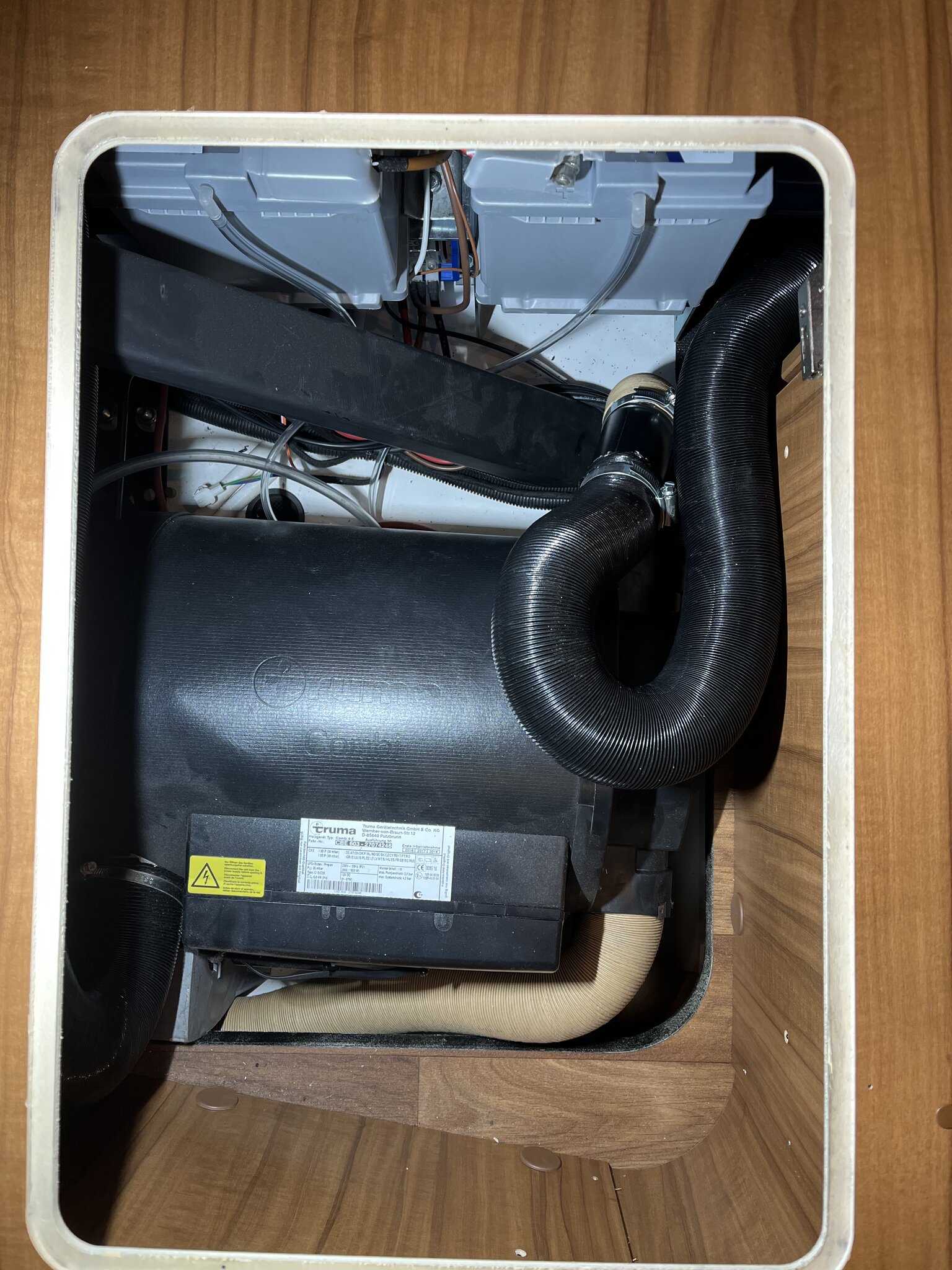

Eberspacher do not recommend connecting a diesel heater into the Truma vent system. This is exactly what they did, fitted a Y piece into the Truma to come out of 2 ports into the drivers cab, which is useless as its the rest of the van that wants heating. They should be two separate systems.
