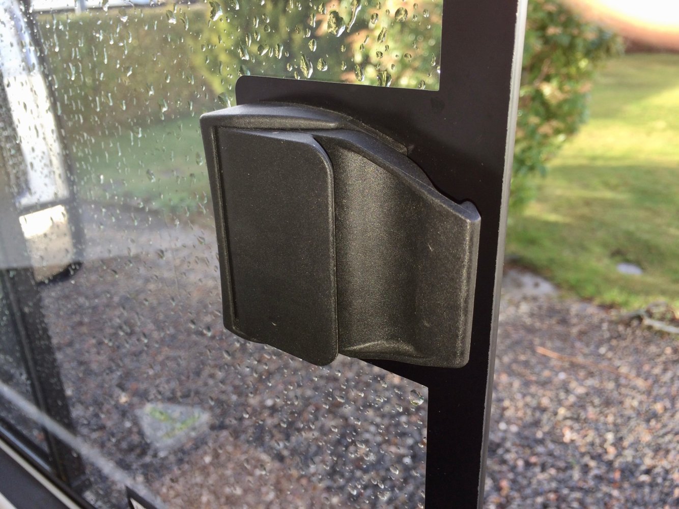

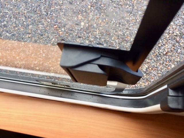

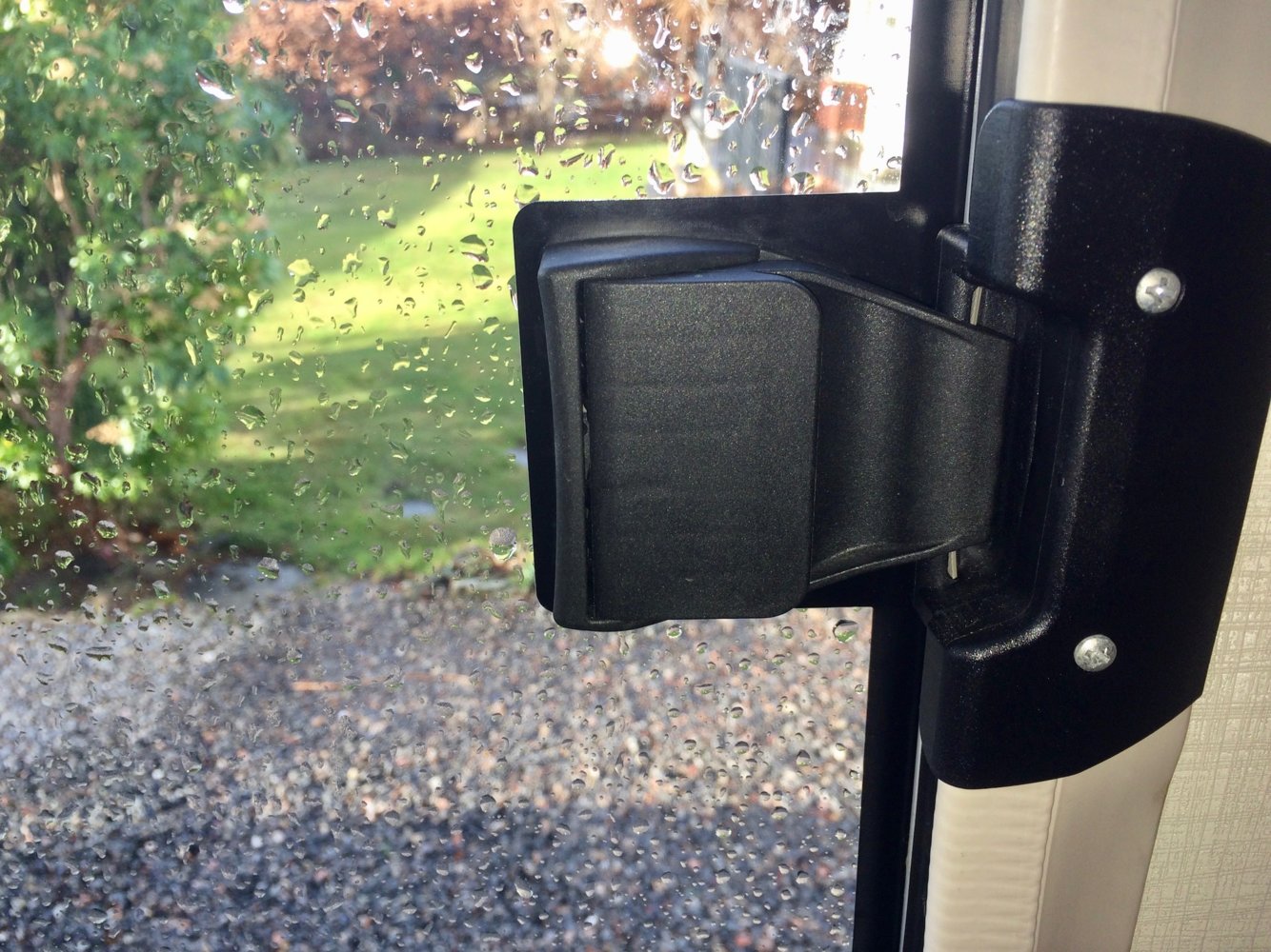

I recently purchased a 2015 Hymer Exsis i-504 A-class. It is a right hand drive version and the drivers side siding window rattles when travelling on uneven roads.
To rectify the rattle and reduce horizontal play I am hoping to adjust the latch part that is fitted to the glass window but unsure how this latch comes apart. Note:- I have dismantled the latch part fitted to the surround, unfortunately it does not have any scope to adjust.
Before I end up breaking the latch trying to dismantle. Has anyone had any past experience working with this type of sliding window latch ??

I presume that there is a gap between the catch on the lock and the keep on the window frame. You might like to consider a fairly simple modification by getting some black Milliput and fashioning a thin strip along the keep. Once it has hardened you could file it down bit by bit until the catch holds tightly. Haven’t had a similar problem with my Hymer but have used this method on another problem issue and it worked extremely well.

Could you try gluing a section of black cable tie or similar strip to the latch on the mating part fixed to the frame?

You could just space the latch plate off the bodywork and if that works you could make a black plastic spacer to sit behind the latch plate.

I tried the black Milliput on the latch keep and it looks like it has solved the problem rattle. The Milliput is very easy to work with and I am sure it will come in handy for other small jobs.
