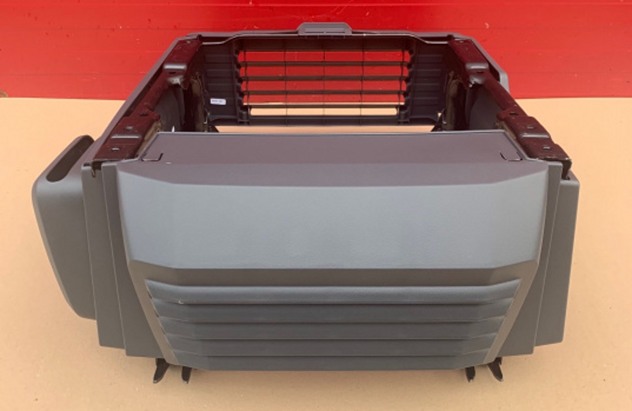

I want to remove the rear panel surrounding the base of one of my front seats.
It looks like it (just) clips on, but I cannot persuade it to unclip.
I'm sure I've done it before but cannot remember how and I'm sure brute force is not the answer.
Can anyone provide a clue?
Images are off the web as I also couldn't persuade my phone to send them to my laptop.

Hi there. The front just pulls down and lifts out. The rear bit has two plastic bits on the top (as in the 2nd picture) that you prise up and it too lifts out of the plastic clamps at the base. The sides are screwed in place
Kev
Reactions: two
Pulled down from the top then unhook the bottom the hardest part is pulling to top out.
after that it’s easy.
put back in the same way bottom in first then puts the top in.

I tried prizing two tabs up at the top near the sides but maybe not far enough. I'll have another go...

mine are held on with 2 screws at the top
Well, folks, thanks a million.
I just needed more confidence that I was doing the right thing.
It required a lot more leverage than I had expected but now I have more space to working in (and am €2 richer)!
