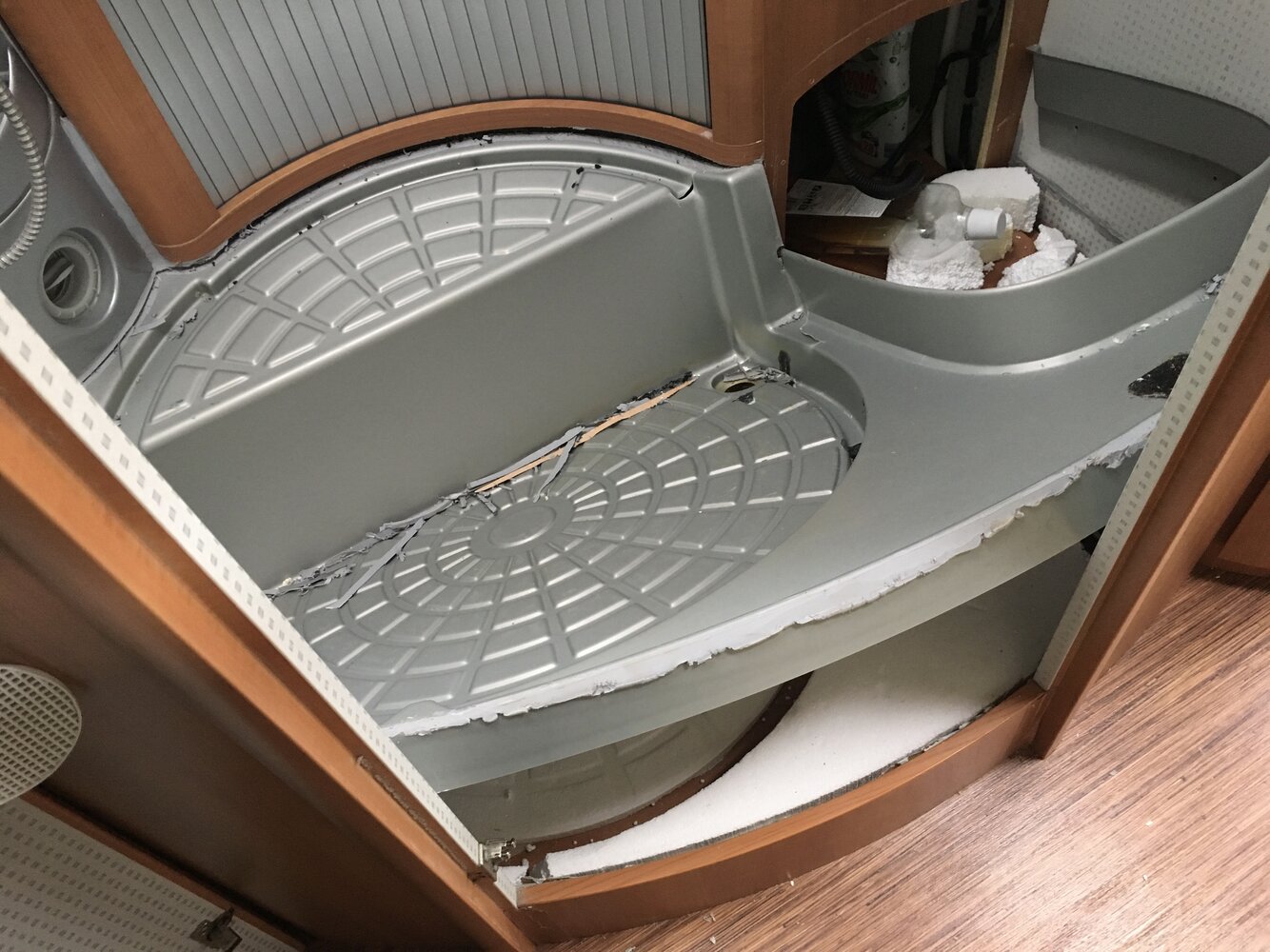

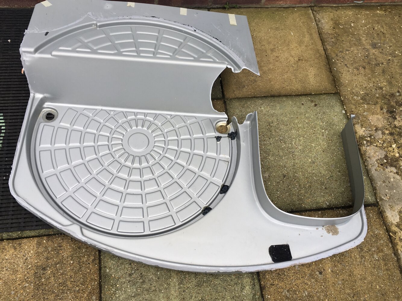

To change the left hand shower trap you have to take the tray out.
The right hand one can just about be changed by removing a panel in the cassette locker.
It is a major task fitting a new tray. You have to remove the toilet.
On advice I made a wooden Profile base to sit under my tray.
The problems are caused because the tray sits on polystyrene packing and over time this compresses and allows the tray to start flexing leading to cracks.
I attach some photos
photos of the work in progress when I did mine.
Good luck.
edit. The wooden profile base sits under the circular ribbed part of the tray.

If you can get a fibreglass replacement I would go for it. I eventually sourced a genuine replacement and they are not particularly strong.
I attach some photosView attachment 443850View attachment 443851View attachment 443852photos of the work in progress when I did mine.
Good luck.
