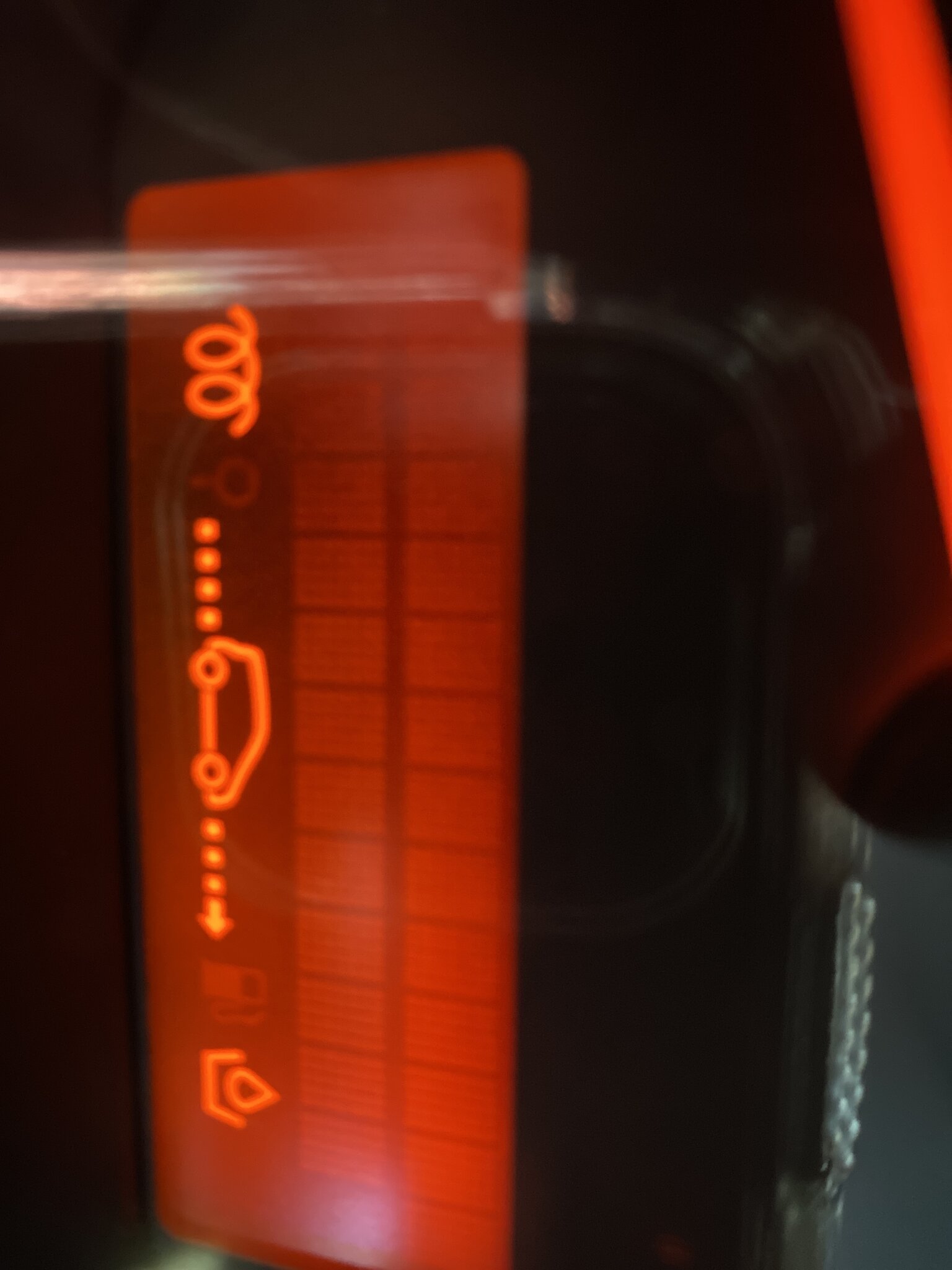

Help needed traveling with this fault on dash. Can’t find out what it means. Van is driving as normal. Thanks in advance.
It that water in fuel filter? (Last part)
It always used to mean glo plugs bur it can come on for anything nowadays :( but the dotted line useually means something is going to happen shortly, it's not add blue is it.?
I’m sure it isn’t as that’s a different sign and I can see that come on and off next to its gauge
Just as a precaution I have put 5litres in I bought with me
We shall carry on with our journey as the van is driving as it normally does
I have checked water in coolant and level is correct

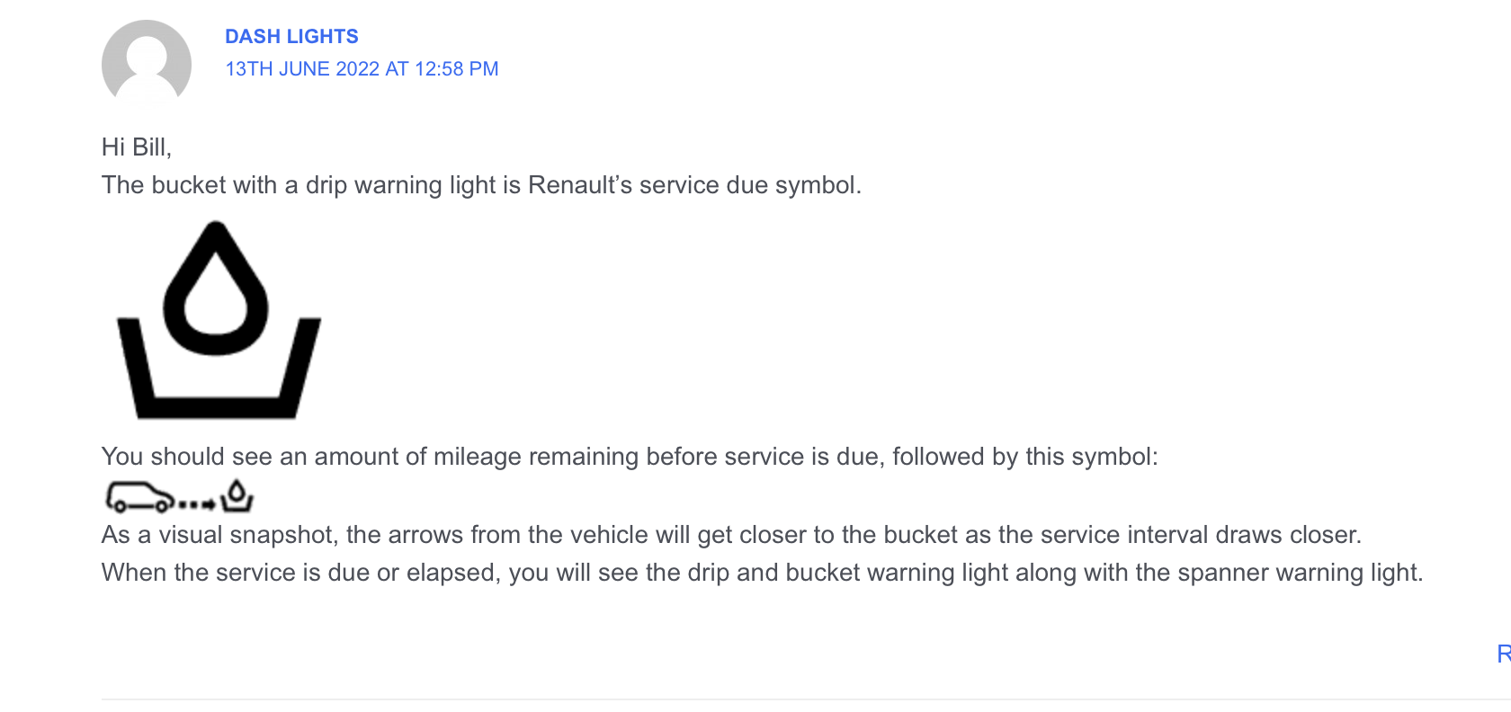

You can reset the service reminder, and your garage should have done that when it did the service
Broken Link Removed
Thanks it was done as I saw on dash after it said over 25,000 miles till next service
With having the two lights can it possibly mean the glow plugs are on the way out and will need serviceing . Bit unusual I know but I suppose it could do.
the glow plug light also illuminates to indicate 'other' faults. certainly on Ford's.
