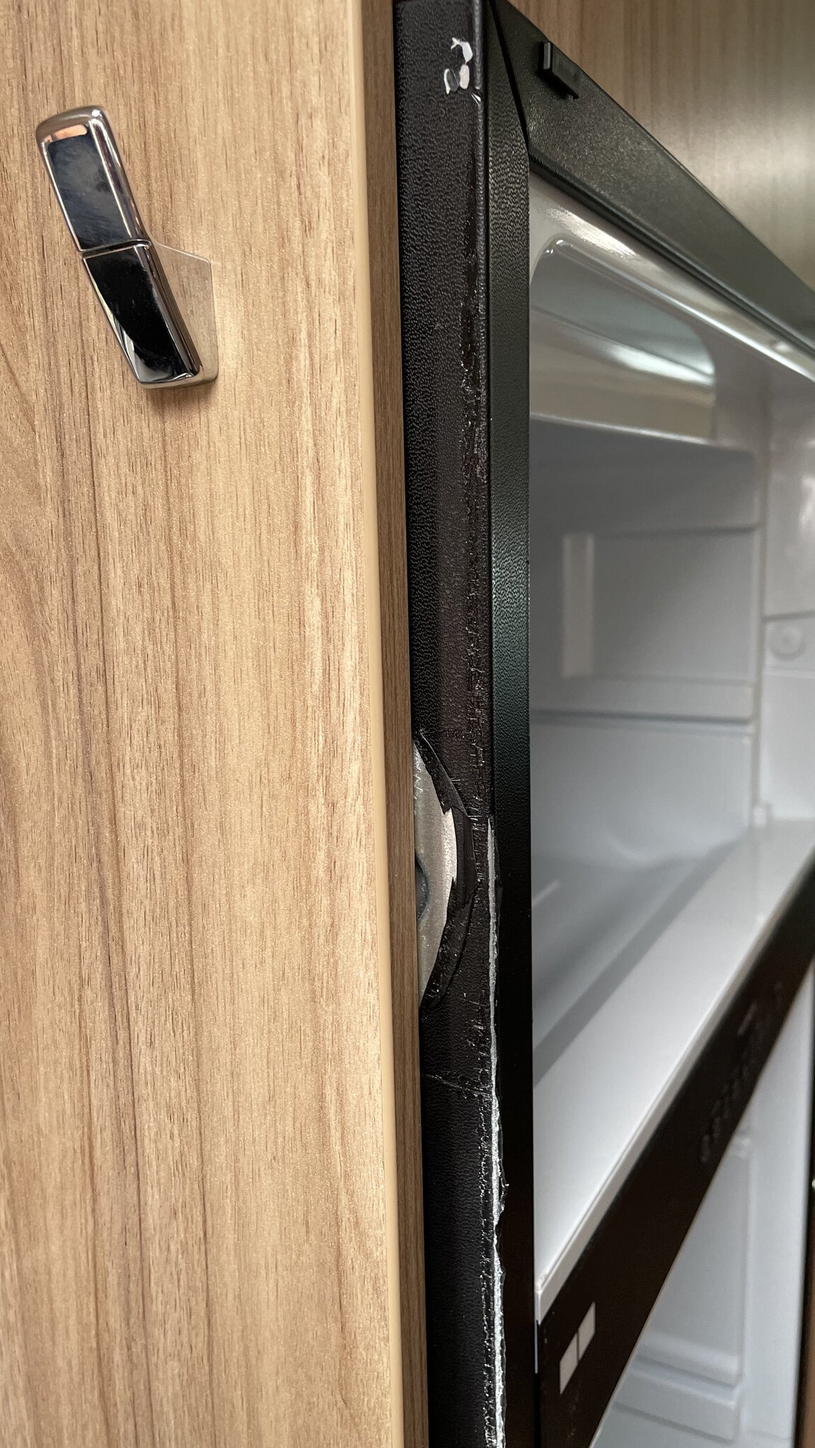

Thanks for ALL the information and making it encouraging to do the swap -‘we’ve just done exactly the same as you did !
Very impressed with the new Thetford fridge freezer T2160.
And just for a slight update we had to remove the aluminium 90degree spacer bars closest to the outside wall in order to slide the new Thetford back in far enough…….and then I bought some LS300’s to simply fit over the existing vents - job done!
So now just to move on our old Dometic RMD8505 - still working but we’re moving away from gas to full time elec’s ! - so if anyone wants to put an offer in for the old one then please send me a PM 👍
